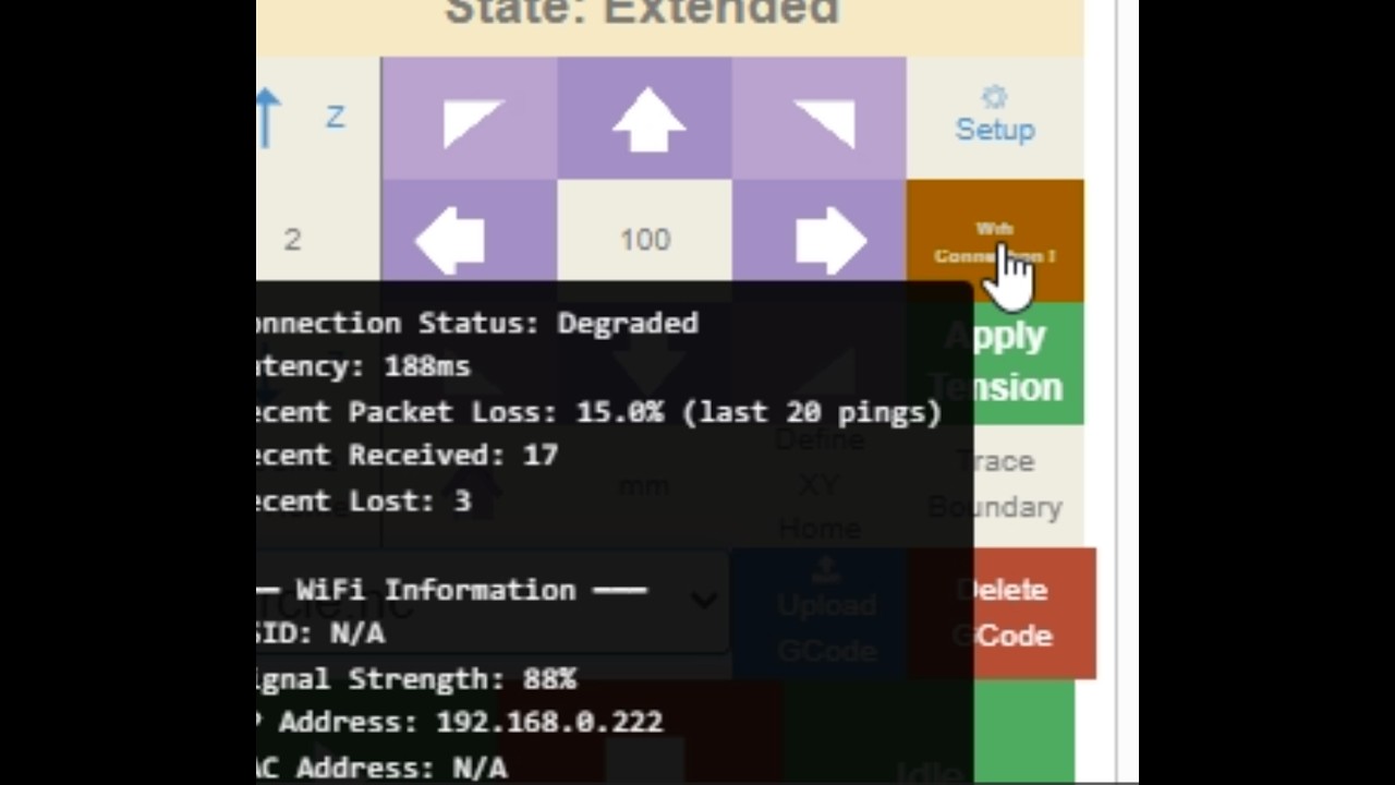

Here is an experiment in adding connection monitoring. It adds a wifi connection status indicator to the main control panel and hovering over it will give more detailed information about the status of the connection:
I’m not totally sold on it and I want to do a lot more testing before merging something like this that runs all the time in the background, but I think that it’s an interesting concept and I’m curious to hear feedback and see what other folks think of it.
In particular what wifi signal strength do yall see? Mine is always 100% so I’m not sure if it’s working right :stuck_out_tongue:
@Smiley and @Caleb_Yager if you are still having wifi connection issues would you be willing to give this a try and let me know if it seems like useful information for you?
You will need to update both the firmware and index.html.gz file for it to work:
firmware.bin (1.9 MB)
index.html.gz (133.5 KB)

Hi @bar loaded this and recorded results, had a couple of dropouts which I wouldn’t have known about otherwise. Just left it running most of the time. Dropped out after 1 min, 2 min and around 3 minutes in video.
Thanks for testing! It’s great to see that the signal strength gauge works :grinning_face:
It’s weird that the connection interruptions seem to happen right on the minute marks, but maybe that is a coincidence, I did see another one at 3:44.
Maybe this would be a helpful helpful for debugging to see if something like a particular cell phone being close by or something would lead to interruptions.
I know with the original Maslow design I found that I had one particular corded drill which would disrupt USB communications…it took a long time of trial and error to figure that one out :joy:
Is that ping coming from the Maslow or the Web page?
Its the web page sending a ping to the Maslow
I opened a 2nd browser to Maslow, ping failed at the same times on both.
