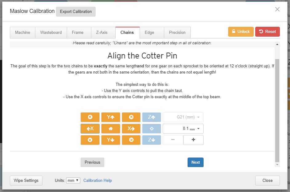

Onto the issue at hand, as the title says, I’ve made it to the “Chains” portion of calibration and am at a loss for how to get BOTH gears at 12 o’clock. The cotter pin will not fit in the barrel end of the chain so a nail was used, both chains were tightened and centered and we can get the left motor to the 12 o’clock position but the right motor does it’s own thing. No combinations we tried got BOTH motors to 12 noon and now we’re here. On the old software you could control the motors independently and rotate them by degrees. I contemplated removing the gears but that can’t be right as the set screw needs to engage the flat portion. What are we missing? I’m certain it’s something simple!

X-axis allowed in this screen so it was possible to get a pair of NOON gears, however…
Two screens later the X-axis is no longer allowed thus making a pair of noon gears seemingly impossible. They can get close but not what I would consider to be precise.
Are we intended to bounce back and forth between steps to get both settings dead nuts?
Thanks again!
The Makerverse calibration seems to be completely broken at the moment. This is all very frustrating.
Hi, same problem here - any solution to move the sprockets to 12 o’clock independently in makerverst?
Thanks
Markus
