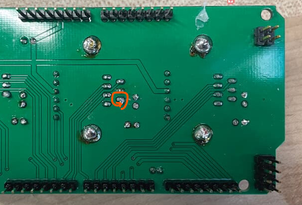

Can you post a picture of your motor control board?
good pictures. Can you tell me the numbers on the chip that is bolted to the heat sink? I can’t quite read it in the upper photo because the chip is vertical.
I ask because I can see the z axis (M2 channel in the middle) uses pins 7, 8, 9 of the arduino Mega I just wanted to verify the firmware matched the chip type and is activating correctly. I’m trying to identify if this is a 5206 board. If so, the firmware should match the chip pinouts. If they don’t match, then that is your problem, but it may just be a double check.

Numbers Read: Horizontal 5206-2s
Vert: GAL739
TLE 5206 board version 1.4 checks out. pins on the 5206 using pins 7,8,9 for in2, EF, and in1 respectively for the control pins on that chip from the datasheet line up with output en4, error flag enB, output en3 as described in firmware. It should be fine. The picture shows a weird blob on the solder joint for the positive power pin on the z axis 5206 chip, so check that
but that might be a longer pin out of focus and may not be an issue at all.

Ok, so I reflowed the board and added on an insulating layer of E-Tape to the bottom side.
