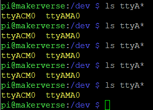

ssh in to your raspberry pi and
cd /dev
ls ttyA*
do you see ttyACM0 or ttyACM1? try the ls command with the controller connected to each of the USB ports on the raspberry pi and see if it shows up. What power supply do you have for the raspberry pi? Is it rated at 4 amps or more?
Yes, it showed the ports with the control board plugged into each of the usb ports on the raspberry pi.
