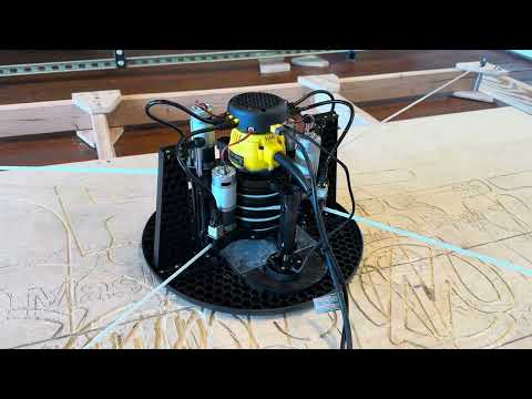

Just finished running it and no issues with the gcode itself :confused: (Video is uploading)
Other than a couple of slightly weird z-axis moves it seems totally normal.
What am I doing wrong then? To recap the events.
  1. ran homing (retract x2, extend all, fully, put pins in, take slack)
  2. jogged to all 4 corners confirming belts were tight throughout.
  3. jogged to bottom left.
  4. Load File.
  5. Click on Z, DEFINE HOME.
  6. Click on Define Home.
  7. Click play.
That’s a 9 degree spiral ramp into the work piece.
So it’s not the gcode that is the issue (gcode shouldn’t really be able to do that anyway)…and also I’m not really seeing anything in the print statements that seems like a clear red flag. The position error being 15mm and it halting is telling us that something is wrong, but it’s clearly pulling way way too hard which seems like a bigger issue than that.
Nothing, you did everything exactly right. That’s 100% the same set of steps that I took.
When it went up to the top of the board like that, what was it showing on the screen like this?
It looks to me like it goes further than it would need to move to get to where the pattern starts.
Edit: Like did the machine seem to think that it had not moved far enough or something? I’m sort of grasping at straws here, but I don’t have a good theory so any information helps
I don’t remember. I never really looked at the layout, just at the xyz coordinates. Which when I clicked the home went to all zeroes as expected.
I’m positive that you aren’t doing something wrong. Whatever is wrong it’s a bug in the software. There is no combination of buttons or gcode that should make it possible to break a belt…I’m just not sure where that bug is…
When you click home, does that set the G54 WCS to zero? I’m assuming the machine position is wherever the router is in space after take slack.

When the machine moves to a new location it uses two belts to pull itself there and the other two are slack. The thing is that one of those belts usually finishes pulling first (especially on sideways moves it seems like) which can lead to the second ā€œpullingā€ belt going slack. Then when we start to take a measurement the opposing belt to the one which is a little slack pulls tight and the slack belt pulls really hard to fight it.
I think that might be what you are seeing. It’s only an issue in the horizontal mode I think.
The solution might be to automatically take up that slack a bit at the end of the move.
