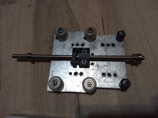

Hi all, looking for some help on assembly. First, the spacers on one of my linkage arms are on the opposite side of all the assembly pictures. Should I swap them to the other side or will it matter?
Next, I have the new z-axis and am not sure how to attach the clamp. I canā€™t screw from inside the z-axis to the clamp because the holes in the clamp arenā€™t threaded. I can attach them from the clamp to the z-axis but the holes on the clamp arenā€™t counter sunk so they donā€™t sit flush. Is this how itā€™s supposed to be attached? Does it matter which of the 3 sets of holes I use?

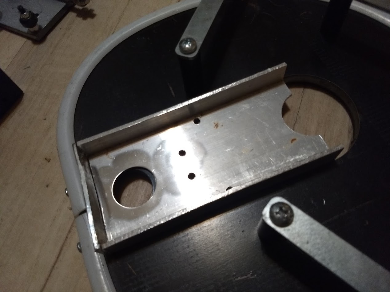

Finally, whatā€™s this little plate? The screw holes line up with the pattern on the sled but that was my only clue.

2nd photo. Thatā€™s weird. Mine were all countersunk, and there were a few sets of holes for adjusting. I just put it in the lowest position I could, that all 4 screws would still go in. And my router clamp was threaded. You must be using a different router? Like the Makita one they recommend? That clamp looks totally different than mine.
3rd photo. That is the dust chute. You hook it up just like you have it in the photo, but where the solid side is facing upwards. The vaccum hooks into the hole where the solid edge is. The c beam bolts go through the sled, through the chute, and into the bottom of the c beam to hold it all in place. Donā€™t forget to use blue thread locker.

Thanks so much, that is very helpful. It is the Makita clamp. Thereā€™s plenty of space there so I may just use some longer screws with nuts.
Sorry for not responding to this thead for a while. I was out of commission due to a back injury. If you are using a 3.5" or bigger diameter router we counter sink the back side of the gantry plate. If you are using a smaller Makita router then the holes are instead threaded and screwed in from the front. if we sent you the wrong plate by accident send us an email and we will get it fixed.

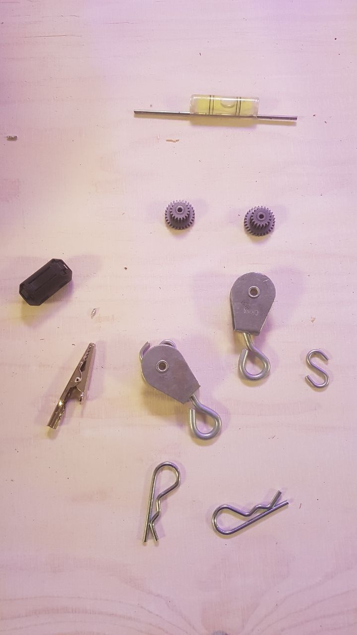

Now I am left with these:
What are the gears for?
the gears are extra ones in case your gear motor gets stripped. SAVE them for possible latter use. black ferret choke goes on usb cable.
aligator clip can be used with ruler and extra black/red/yellow/red wire to make a zeroing device, small pullies are for white rope and large pully is for metal chain. I will try to get some photos, but there are a few threads on the forum about counterweights that show photos.
