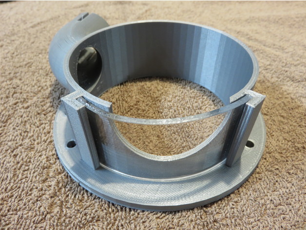

lol I was wondering what this piece was for. After making a few cuts I was just starting to look for vacuum solutions and this looks great. Thanks for the inclusion on the kit. Perhaps it might to be time to review the instructions on the metalmaslow website as I still have a couple extra pieces from the kit that I’m not sure how they are supposed to be used.
Is there any 3D image of the metal sled available? It would be handy for designing a solution which will raise the linkage for the Ridgid router (to 3 1/2 inch?) and integrate this vacuum adapter in one piece.

I thought the metal sled had a vacuum passage underneath with a vacuum port built in. If you look at the metal maslow web page, they have pictures:
On my wooden setup I countersunk a piece of acrylic with a hole i the middle so the chips don’t get away from the vacuum along with some v grooves from the edges for more air flow so the sled doesn’t stick to the work piece. Works pretty well.
The point: the 3D printed attachment you seek is not the only solution for a metal sled vacuum attachment. The metal sled has 2 vacuum options:
  1. Uses the under side of the sled with the plastic slider as the vacuum seal
  2. C channel on top of the sled someone recently posted on facebook asking what the c channel piece was for…
    I believe that goes on top of the sled as a vacuum channel.
Good luck!
Hi,
i have the older (round base plate) version and yes it includes this metal vacuum adapter you see below. With the Rdigid router one has the problem that its “head heavy” and one needs to raise the linkage kit to about 3 1/2 inch to counter this. As the metal maslow vacuum adapter raises the router height again i am looking for a solution.
i can send you the dxf, but not sure it would be usefull. one just prints that gray vacuum adapter and then uses epoxy or double sided tape to stick it on the metal sled. to make sure it is centered all one has to do is lower the router down to make it centered. should take 5 mintues todo. sometimes it’s best not to get computers and drawings envolved if can be done simply.
