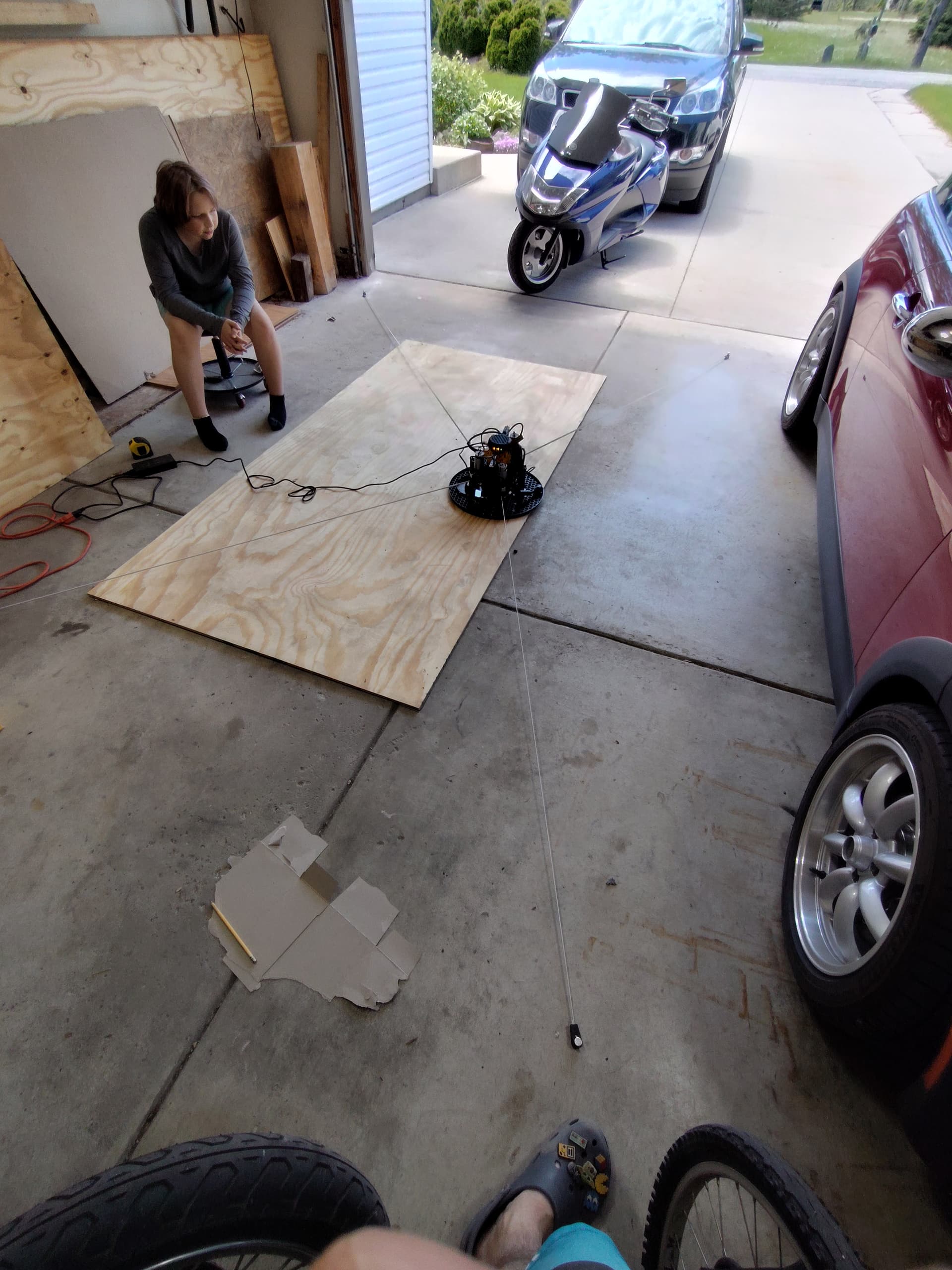

Currently I’m using a horizontal setup on a concrete floor. I have holes drilled in an 8ft x 12ft rectangle.
2924.300mm h x 3657.600mm w
Ive updated to 0.72, and run the calibration several times, and I’m getting the following error:
[MSG:INFO: Center point deviation: TL: 0.311 TR: -0.006 BL: -175.222 BR: -302.372]
[MSG:ERR: Center point deviation over 100.000mmm, your coordinate system is not accurate, adjust your frame dimensions and restart.]
[MSG:ERR: Frame size error, try entering smaller frame dimensions and restart.]
Welcome to the club
In the calibration config, don’t use accurate frame size numbers.
Give it a nice round number that’s about 150 to 200 less than the accurate values.
I’d hope this isn’t still necessary with the newest firmware, but this seems to be a requirement to have successful calibrations with 0.70 and prior, at least.
After 8 reduced the size of the machine I now get this error:
[MSG:INFO: Center point deviation: TL: 0.142 TR: 0.045 BL: -83.581 BR: -91.179]
Reduced the size of the machine again and it finally calibrated whew!
