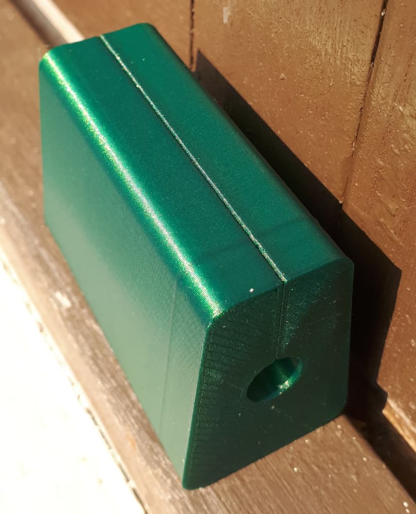

My first test with sled manufactured in 3D printing and dental plaster
Vase mode 3D printing, saves material and time.
Dental plaster is pressure resistant and good price.
To resist buckling I used wire in the middle plaster.
This is the first prototype, I’m going to correct the height of the chain.
Distance between lines 0.4 mm for vase printing.
0.2mm accuracy in 3D printing.
Plastic wall thickness is 0.4mm.
