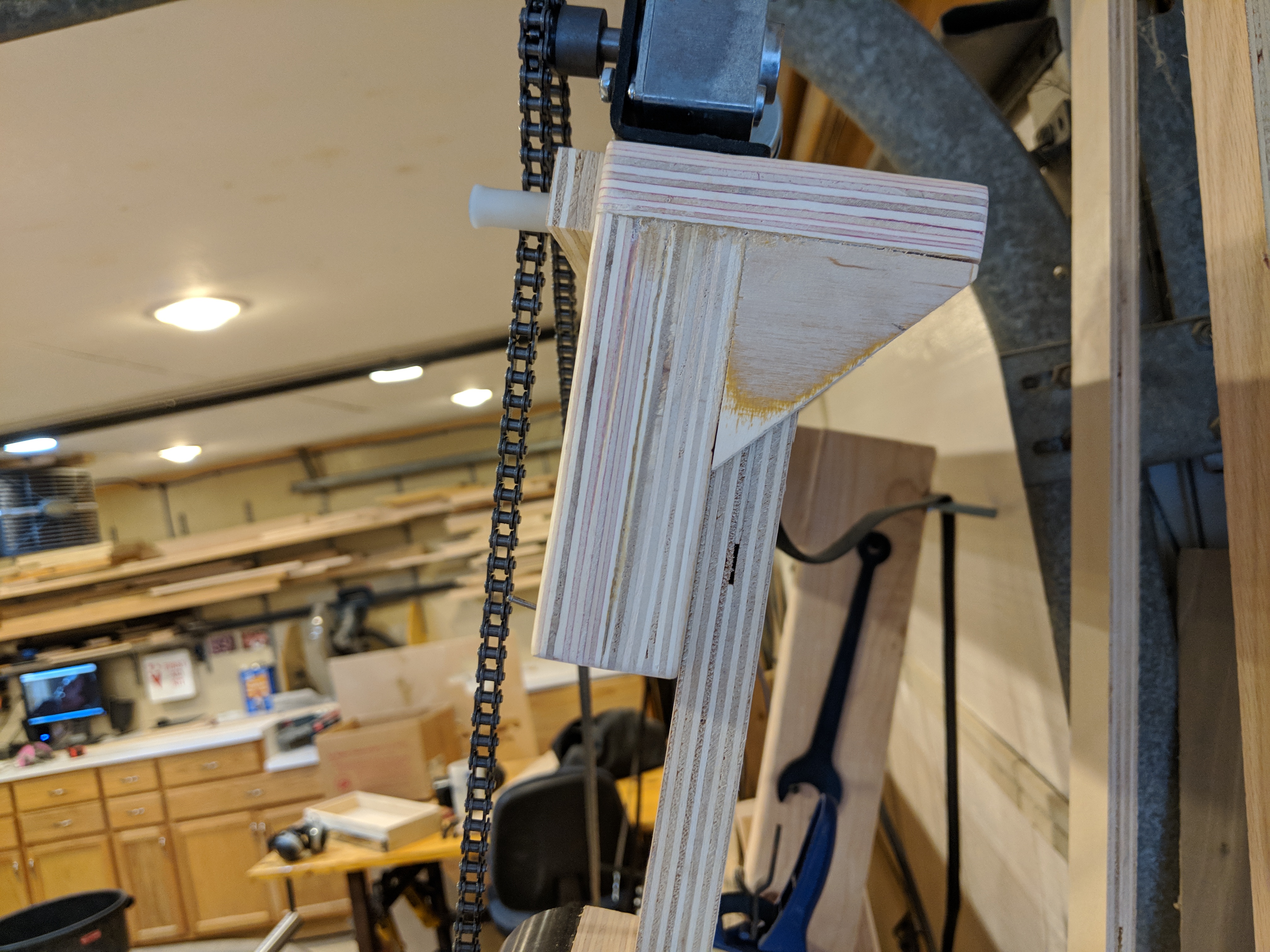

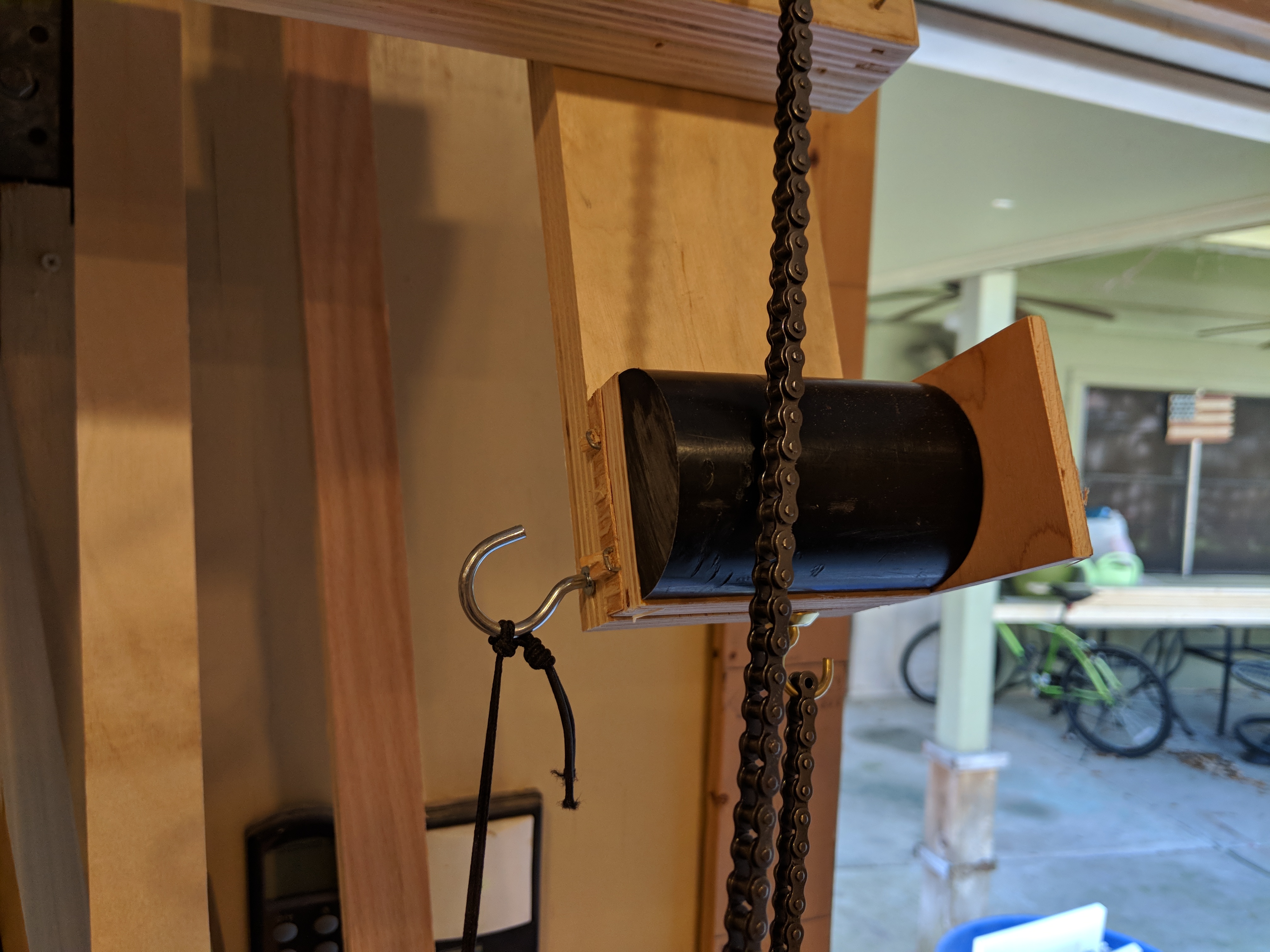

I make cabinets as a job and as a result I have lots of 3/4" ply cutoffs, so I made a laminated topbar out of 3/4" plywood. The main bar was made of 4 pieces. (2) 8 foot lengths and (2) 2 foot lengths. the joints were placed at opposite ends of the bar. It was glued with TB2 and screwed together. I also added flats for the motors to sit on and to add rigidity. The results are very solid with no deflection under load. Add to this that given normal conditions it should not bow over time and I am very happy.

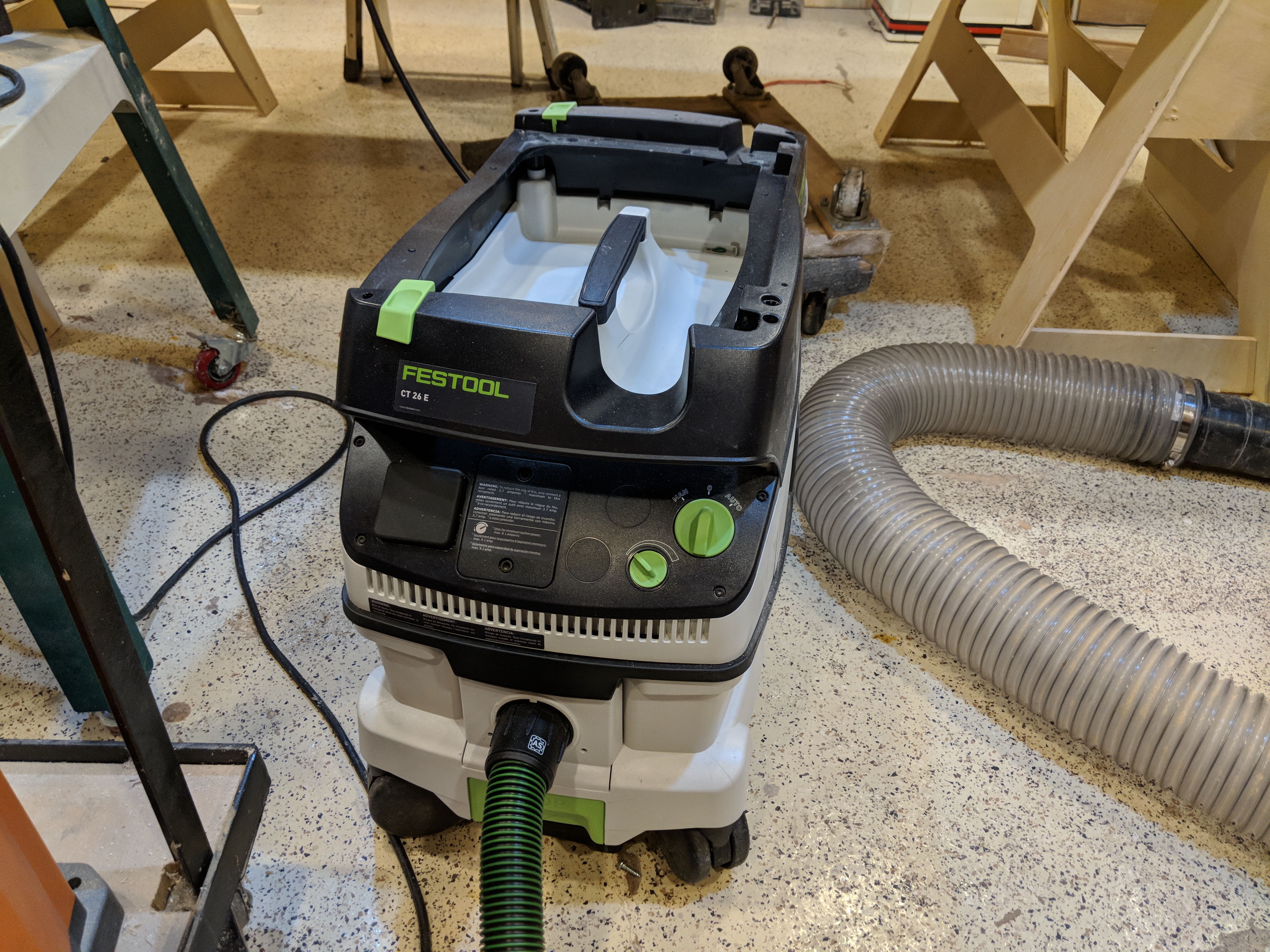

For dust collection I used one of my Festool CT26 and the shroud that comes with the ridgid router. The dust collection is very good. The vac creates enough suction that I have to break the suction bond to lift the sled from the work surface.

With a powerful suction bond such that the router sled bonds to the cutting surface, have you had any issues with the sled moving freely across the cutting surface? Any sled-skip or slip or issues with accuracy at all?
No problems so far. Everything seems to be as close to perfect as i could expect.
