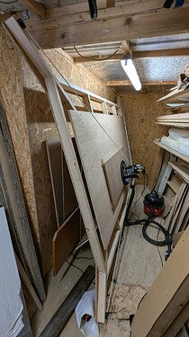

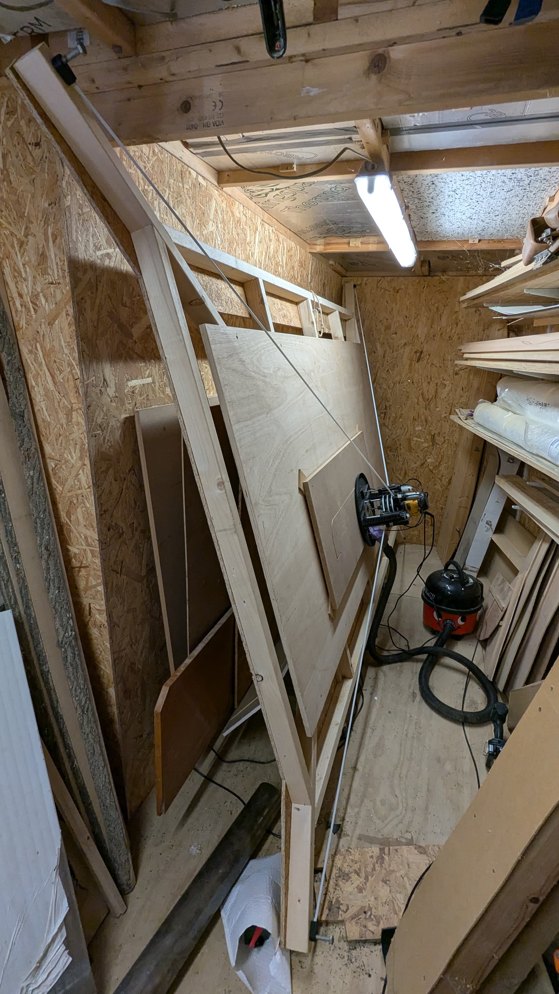

Hi folks, After a bit of a break from using the maslow, I’ve rearranged the workshop and set it up in it’s own space and giving it a proper go. Having had several painful days with the original calibrations I stiffened up my frame with OSB just incase that was part the issue.
A new calibration with the latest firmware seemed to go ok, though I’m still not really sure what a good set of numbers looks like. I’ve then attempted a simple MDF template, Gcode generated in KrabzCAM, cutting with a single flute spiral style cutter, straight off the first pass (~3mm) was looking disappointing, then it stopped before getting back to the start for a second pass.
you can see the straight lines are really wavy, +/- more than 1mm. and the corner in the picture should be sharp.
Before I get lost in the cycle of calibrations and more testing any pointers from the community would be great.
I’m questioning things like the height difference between calibration and the real run.
Do my anchors need to be level with the working face? should I calibrate on a piece of material the right thickness rather than my bed?
Prior to stiffening the frame, the results weren’t that bad. Though I only tried one engraved text design so not really like for like. Still I was pleased. the main issue on this one was it failed to complete and seemed to crash before completing the Gcode. one or two passes before the end.
Any thoughts on failure to complete programmes? I didn’t see anything significant in the output log, maybe because it crashed.
If the machine finished calibration, then it should be > .50 fitness (I think, it may have been lowered recently).
The cuts look to me like the sled might have been skipping / leaning as the cut was going; did you happen to notice that?
What feedrate did you use?
Is the bit sharp?

I’d guess the wobble is a loose belt issue. With the circle cut, it’s only wobbling in certain parts of the path which might be where it needs that one loose belt’s tension. Here are some loose belt issues I’ve had that could cause your issue:
  1. How much flex are in your anchors? I had mine temporarily drilled into the wood and they moved a ton! The Maslow puts a fair amount of tension on the bolts and wood is pretty soft. I believe this also screwed up the calibration as well as when the machine would run.
  2. Did you calibrate with the vacuum attachment on the machine? I noticed on mine that the BL belt interferes with the attachment and messed the calibration up when in certain areas of the board. The machine also needs to have the Z bottomed all the way out and no bit in the router.
  3. Another thing to check is a loose belt when jogging – when you retract and tighten, how taut are they? Do they stay taut when you jog the machine? It might be hard to notice how much they loosen up.
For the deviated path, my guess would be an encoder issue — I don’t think it’ll flag anything until it moves more than 15mm out of where it should be which is quite a lot. My machine dive bombed in a similar way, since the encoders are already hot glued, I zip tied the cables to the top board and haven’t had a problem sense.

Thanks for the tips gives me some good things to focus on next time around.
I did have concerns about my initial anchors and did some work on them to make it more rigid maybe I take them up another level with metal inserts or plates.
I did not calibrate with the vacumm active or the hose attached, but the 3D print was mounted. I had the same thing you observed with the belt touching on the lower left when at the extreme left of the calibration process. I’ll calibrate next time with the vacuum active and the calibration area reduced. I’ve been calibrating with z bottomed out as you say, but I’ve been wondering how the additional thickness of the work piece impacts the same sort of function. Should my anchors be level with the work piece?
I also saw a loose belt when jogging once. I was jabbing jog instructions pretty fast and between a couple of downs and a horizontal i noticed a belt slack for a second then it tightened up. a bit like it does in the first phase of calibration. @kyleschoen is that more a symptom of a bad setup than a specific thing to fix? like do a focus in on the particular belt in question or hope anchors and calibrations are to blame.

you don’t need to calibrate with the vacuum active, just make sure it doesn’t
interfere.
what’s important is that the Z offsets in the maslow.yaml file are correct for
your calibration and your cutting (they can change between the two, but they
need to be accurate for each of them)
The more level the belts are, the less they are affected by adding a workpiece
(see the recent posts in the topic “Corner Floor Mounts and Pins”)
