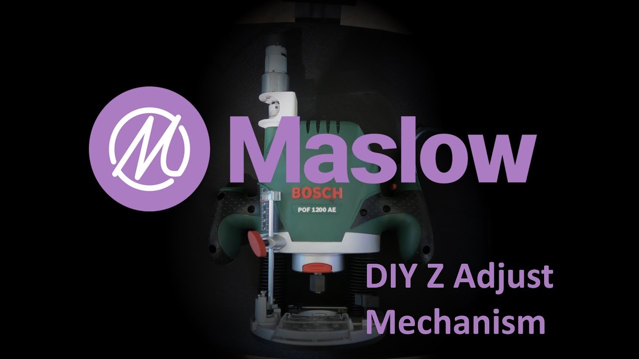

I am also in Europe… looking at the BOSCH POF1200 as the AEG is way more expensive… Here is the conversion hack.
I recall there being 3d-orint files available somewhere for the extra bots - but I havent found them yet…
