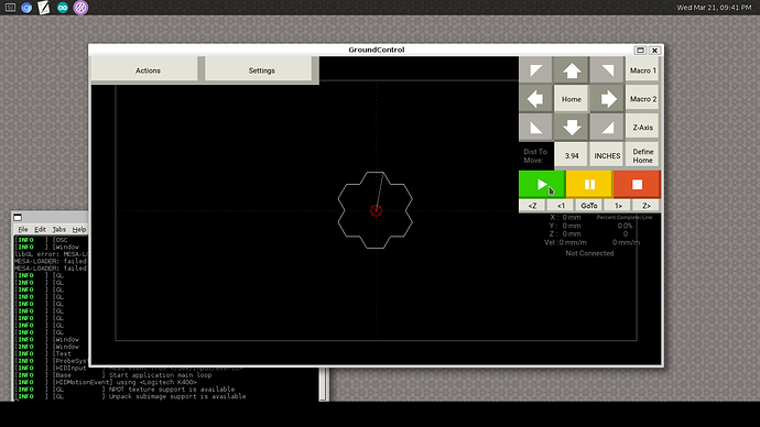

Raspberry Pi running in KDE Window Manager, wayland version
This is a solution, I came up with for running GroundControl or kivy python apps inside an X11 window manager while using a mouse or touchpad. If you are using a touchscreen then running KivyPie is probably the safe choice or running kivypie with the trapped cursor mod that was discussed and uploaded by Kingley in this earlier forum thread.
[Disclaimer] As of this writing I have not yet received my Maslow kit, and I have only been able to perform limited testing on a Raspberry Pi 3b with a bluetooth keyboard and touchpad (Logitech K400R).
Also, be warned you will need to enable the [experimental] GL driver in raspi-config and  that the current ‘KDE Window manager wayland version’ being used is considered a [PREVIEW] release.
Disclaimer aside, I have been able to run GroundContol in a windowed environment without any screen lag or the missing cursor problem, as encountered when using KivyPie without a touchscreen.

This will start the KDE Plasma Window Manager running Qt5 libs. Plasma is a full desktop environment, with lots of eye candy.
Unfortuantly, it also uses a lot of resources, probably not what you want for a CNC controller.
Instead, we will run KDE WM without the Plasma desktop environment. With the following command in the shell.
kwin_wayland --xwayland --exit-with-session=konsole
The screen should turn black with a mouse pointer in the center of the screen followed by konsole app.
The --exit-with-session= option lets us gracefully return to a command prompt when closed, otherwise you will have to open another tty and kill the process. The key thing is that running this way only uses 124 Megs of RAM.
As a test you should be able to run glxgears from inside konsole and see achieve a frame rate of 60 fps.

Now start the KDE Window manager.
From inside the konsole terminal app:
cd GroundControl
python main.py
The GroundControl program appears full screen and you should be able to interact with it using your mouse and keyboard. You should also be able to resize the window it runs in!
