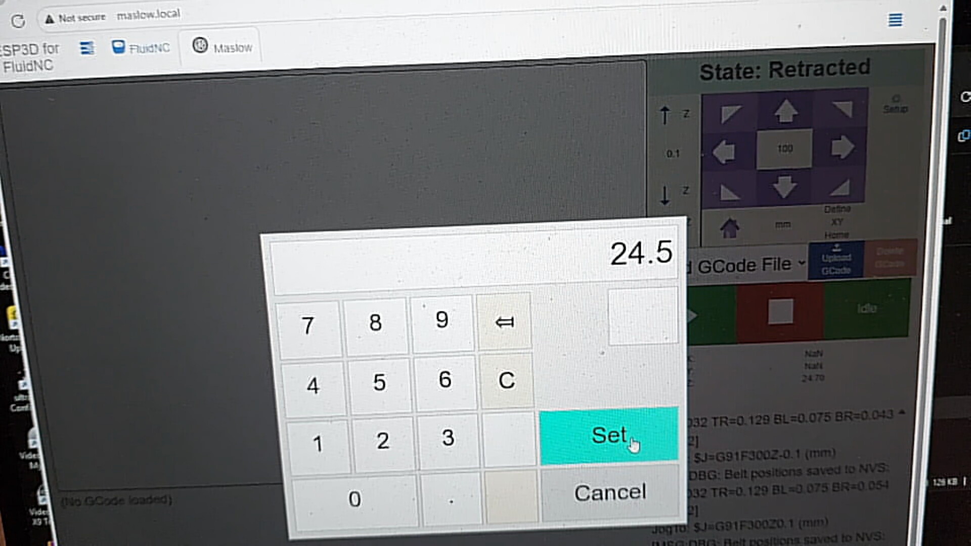

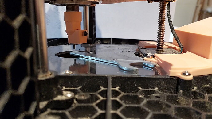

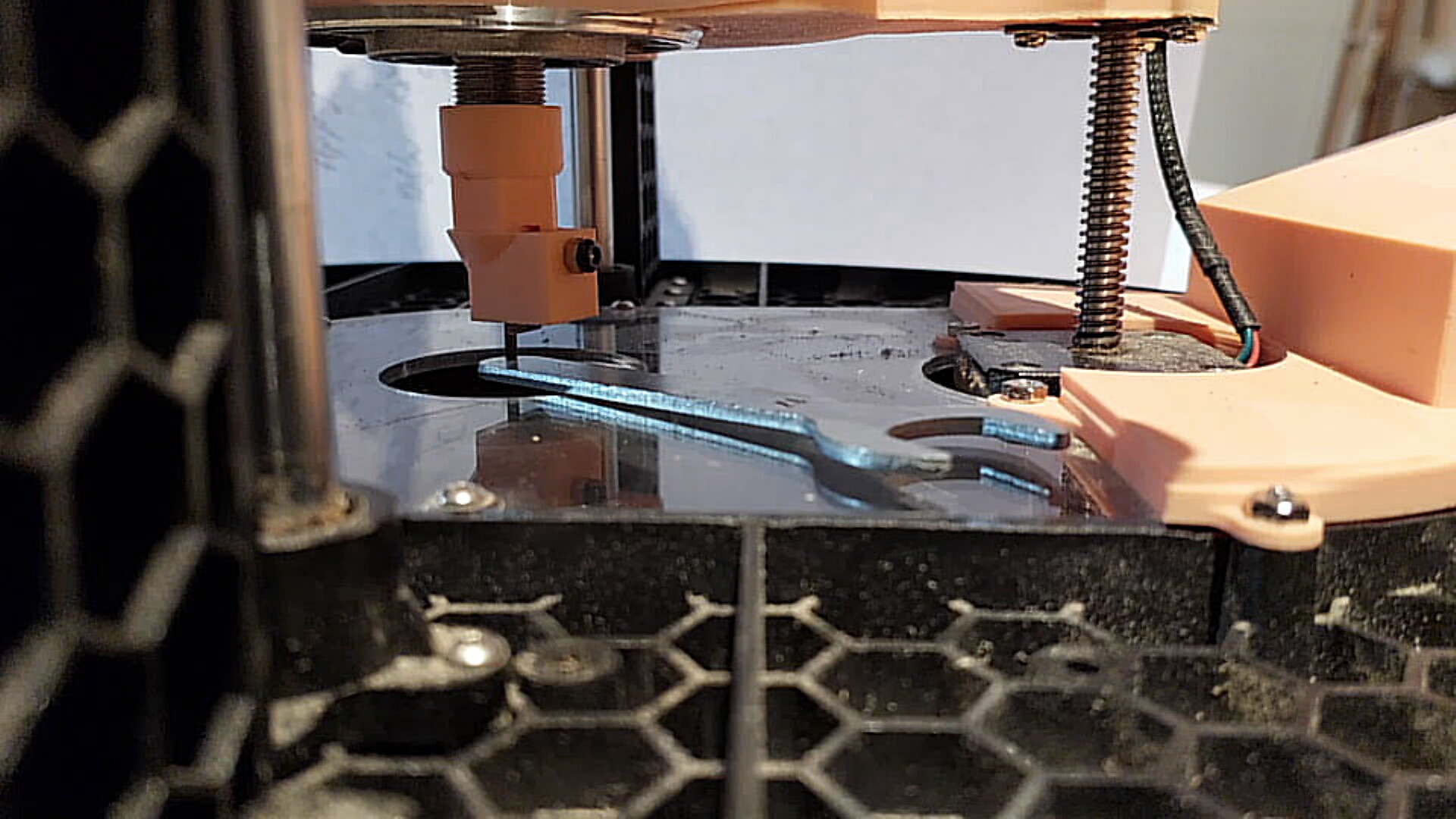

How I do it manually:
Put the spanner under the bit overlapping the hole in the perspex, then lower until spanner end lifts.
Reset Z movement to 0.5 and raise until spanner is level again. I then reduce movement to 0.1 and repeat until I am happy with accuracy. Reset the movement to 24.5 (the distance from job surface to top of spanner for my setup) lower the Z and set the Z home.
