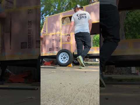

Update, it has a roof! Well mostly.
I used the Maslow to cut the lower partition. The Maslow was short by 1/8" which should be 5’. With the fiberglass this works out and I have to actually shave some off to get it in flush. There is a sliding door so we can get stuff from the cooler without going to the back. The other cutouts are for ratchet straps to hold my Bluetti in place.

The roof is fully glassed. + Front drop.
How I am going to mount everything is pretty sorted. I gave myself WAY to much leeway here.
Inside the sleeping area, I worked on the bunk bed which is removable. I routed cables for USB charging into the frame to hide the cables.

First coat of paint! The sanding isn’t that great. I didn’t get enough of the epoxy drips and you can see were the seams are up close. Considering this thing has it’s maiden voyage in one weeks time not a lot of Bondo is going to be applied.
I weighed the rear hatch and it came in at an impressive 35 lbs!

Just a few small pieces left, but it’s weighed and ready for inspection. It came in at 1,140lbs

Not to be ‘that’ guy, but you might want to consider a drop hitch to lower the tongue just a little bit and have it tow more level.
Lol yeah, I bought a 2" drop earlier this morning.
I had someone watching the back lights and they got within a half inch of the ground leaving my driveway with the inverted 2" I had on hand. Our jeep sits way lower and that was the only receiver I had on hand at the time.

Small but serious update. It’s not waterproof. I was worried about the base to sidewall connection and it seems there are a few missed spots. We had a pretty big storm and afterwards I went to check it out. Water made it’s way from the floor up. This weekend on the deck is to jack the body up away from the frame and wrap fiberglass around the 90°.
