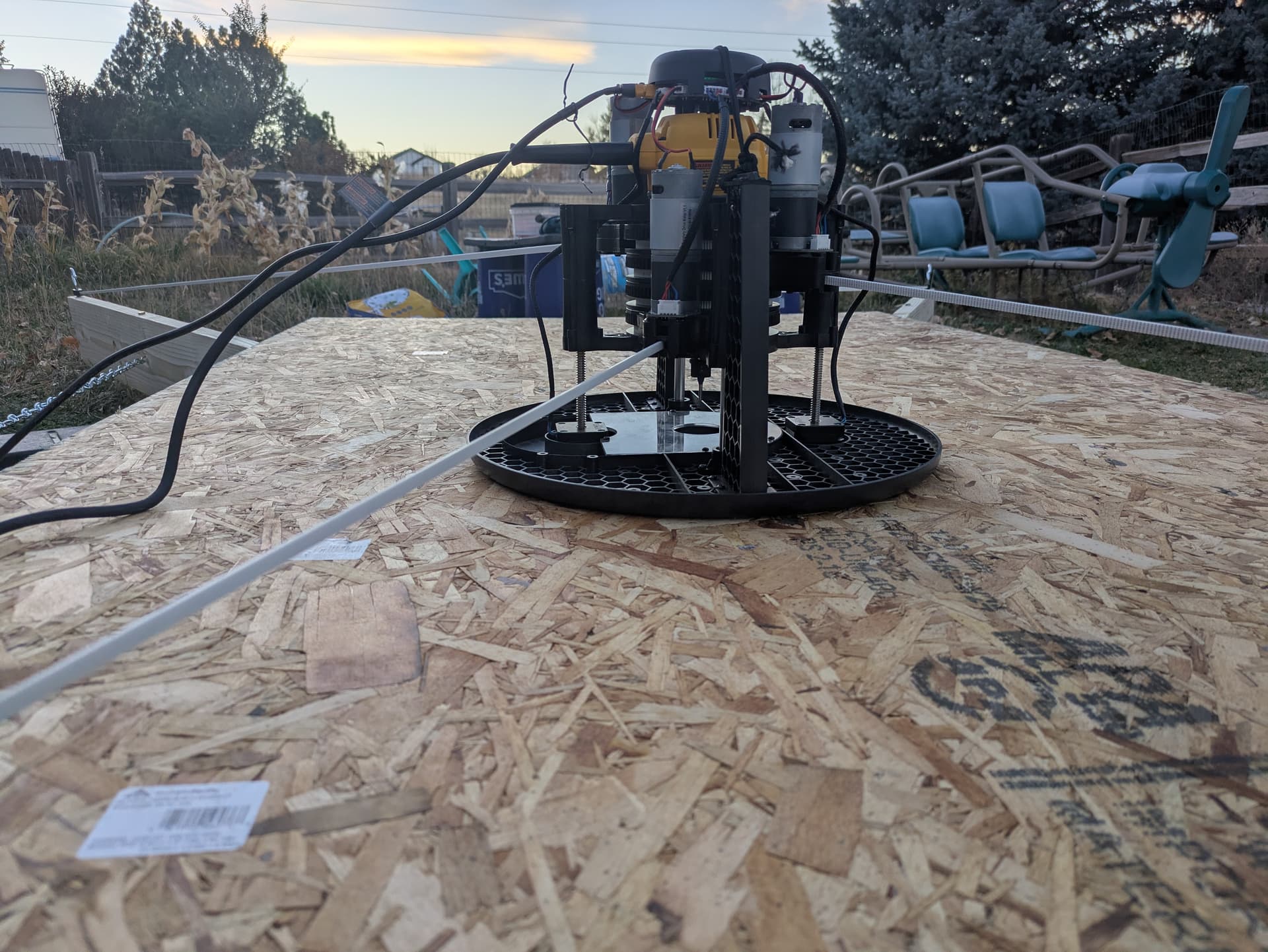

Thank you. quick note. Trying for my first actual cut tonight. DId a dumb thing I really wanted to get cutting so I put the cutting bit in the router, left the z all the way up and then ran calibration. But it went really fast! less than 5 minutes! Then I lowered it to about 2 cm up, and ran it again. I know it is not ideal but I want to try some cutting and it is getting dark. Anyway also fast! then I tripped over the cord and unplugged it but….. It remembered where it was! Yay no retracting/extending!. THank you! Here are both logs, I thought it might be some interesting data with two run right after each other at different z heights.
Loading the cut now. ….. Also it didn’t fall off the board this time. I don’t know what is happening there but it is now good. Pictures are of the different heights.

Excellent! I am glad to hear that we’re making progress :grin:
