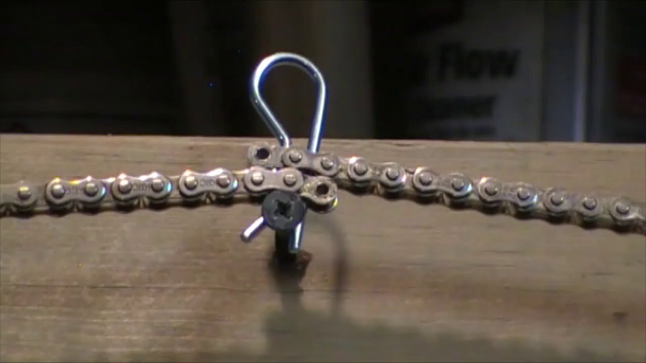

Appendix A: Troubleshooting
  • Resetting Chains (YOUTUBE DEMO) Forum post
  • z axis going wrong direction - check z axis pitch in settings. The default is -3.17. If your z axis is going backwards, it could be one of 2 things:
    • gcode may be telling the z axis to cut at a positive position. Usually cutting with the z axis is a negative Z value.
    • z axis pitch setting may be +3.17 instead of -3.17 or if you have a belt drive, it might need to be +8, +16 ,or +24.
  • motors don’t move - check plugs, swap cables. Verify power is plugged into to the shield and NOT the arduino.
  • circles are not round - skipped a chain tooth or position is incorrect. 1st: reset chains. 2nd, recalibrate.
