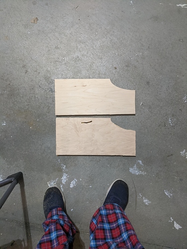

Hi all. Just finished the installation of my new Maslow and am working on a “first project”. I did the Bar/Bolt design stand. After calibration, I did my first cuts. Everything in my piano stand project is basically square cuts.
I’m using Inkscape to create the SVG, converting it to Gcode in JSCut and the cut essentially went off without a hitch… Except that the pieces aren’t square, not accurate and I’m essentially butchering a sheet of plywood.
The sides are a mirror image of the same object.
They are really not close to being accurate. But, Close enough I can salvage them as sides. So, I figured I’d do a simple rectangle. 52.5 inches by 12". Started up the cut, and it went to the correct start point. After moving to the left approximately 24", it was already running up the board and off a horizontal cut line by over 1".
What am I doing wrong? How do I make this more accurate? I have read success where people cut smaller parts at the center of the board, but that limits my ability to do bigger projects?
Since i’m new, I can only attach one photo. Above, those two pieces are off:

That cut looks like you skipped a chain tooth or two. I had a cut do that on Saturday. It was cutting in the upper right corner and the slack side must have folder over. How is your chain-slack management?
Using Ground Control. Chain slack is the bungees from the kit. I watched the chains and didn’t see any skipping. I’m watching close because in my first cut, I had the pin break from the chain and the router go flying. Found forum posts about making sure the pin goes to chain links that are fully in tact.
If you hadn’t seen it yet. Once you get calibrated and centered on 0,0 mark the top tooth on the motors and the link on that tooth.
It can help identify if the chain skipped and realign/re-calibrate if you have a problem.
Also, a lot of folks went to a pulley/weight system for slack management or a single screen door spring replacing the bungie

Ground Control 1.26. Same with the Firmware apparently.
Not sure anything truly failed as a result of a bug, but I think this was user error, that I couldn’t recover from. Everything was in motion when I realized the sled was going to keep going up. Stopping didn’t do anything, maybe it was from the laptop having slept.
