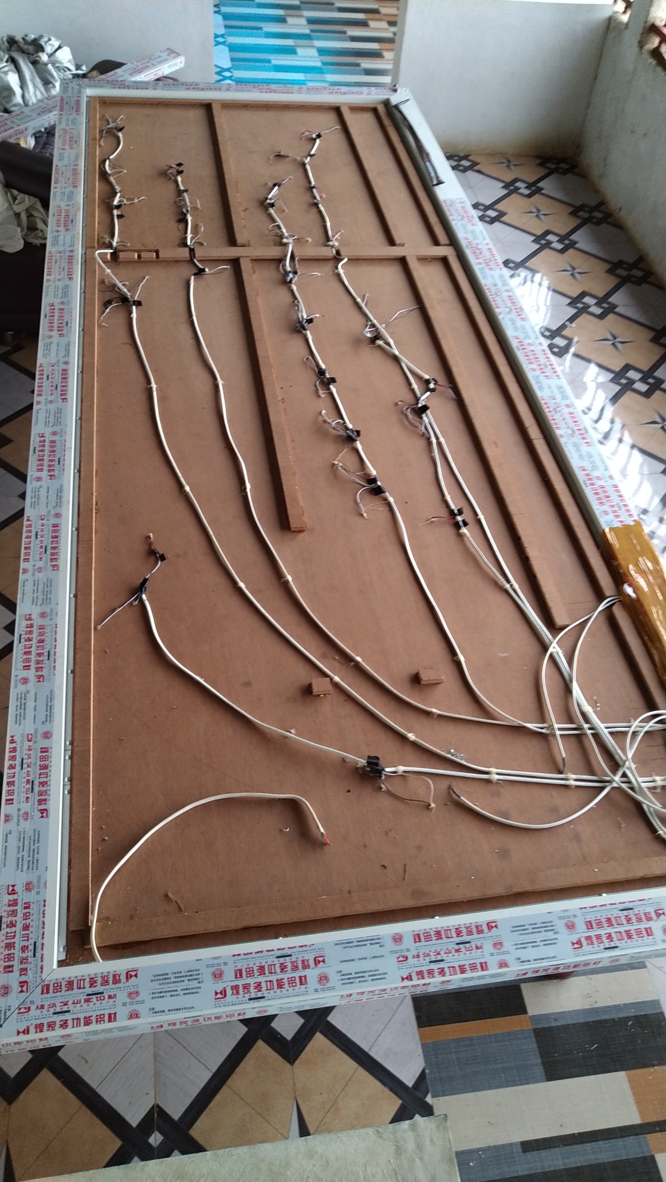

Finally got the sign for Moby’s finished
So that’s
~1.5 sheets of 15mm Marine Ply
~1.5 sheets of 5mm Marine Ply
~13m of 100x50mm Aluminium Tubing
~10.5m of 10x10mm Aluminium Molding
Many, many screws and rivets
~0.5l of black paint
~8l of 2-pack epoxy
34.6m of LED strip lighting (2 different wattages)
2 x 200w 12v PSUs
~30m wiring (various)
3 water proof switches
1 worst flood in 40 years
1 c****y table saw fence cut in half to make two support brackets
Several friends to help get it done
