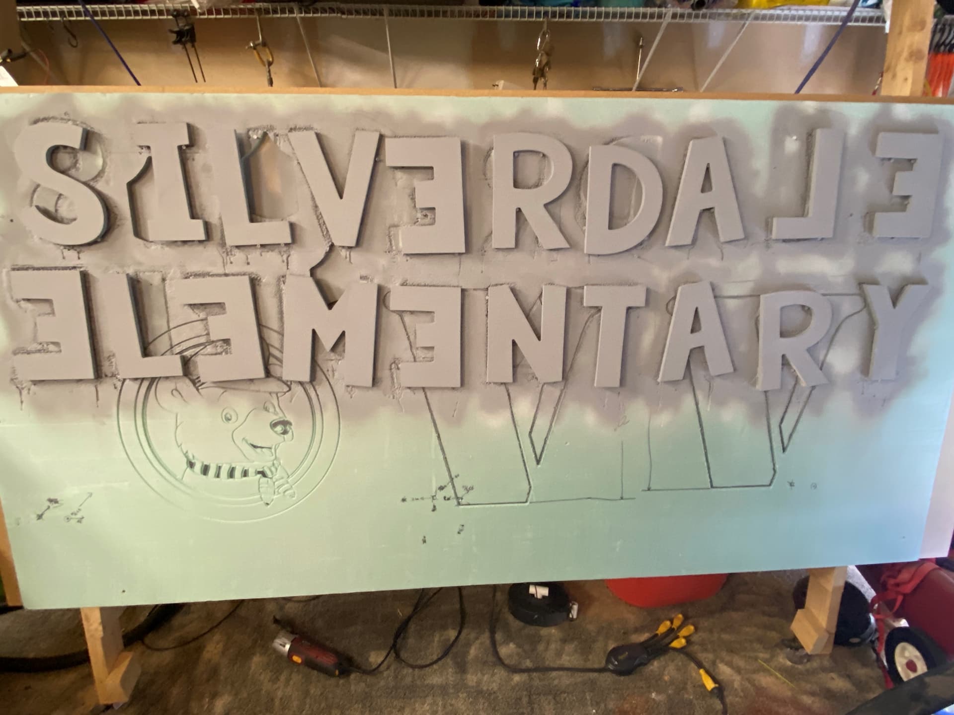

So I have been working on this for a couple weeks now, but the wife asked me to redo the signage that hangs in her school’s lobby.
Workflow was Inkscape for image import and conversion to .SVG, then EsltCAM for the tool paths and GCode generation.
Cut in 1/2" MDF; Letters are about 10" tall, and the bear is approx 22" wide.
Sealed & Primed:
Painted Letters white:
And painted the Bear black followed by epoxy inlay with the different colors and clear coated:
The clear coat is still drying and will be ready for delivery to the school tomorrow. I’ll update once they get everything hung in the school in it permanent residence.

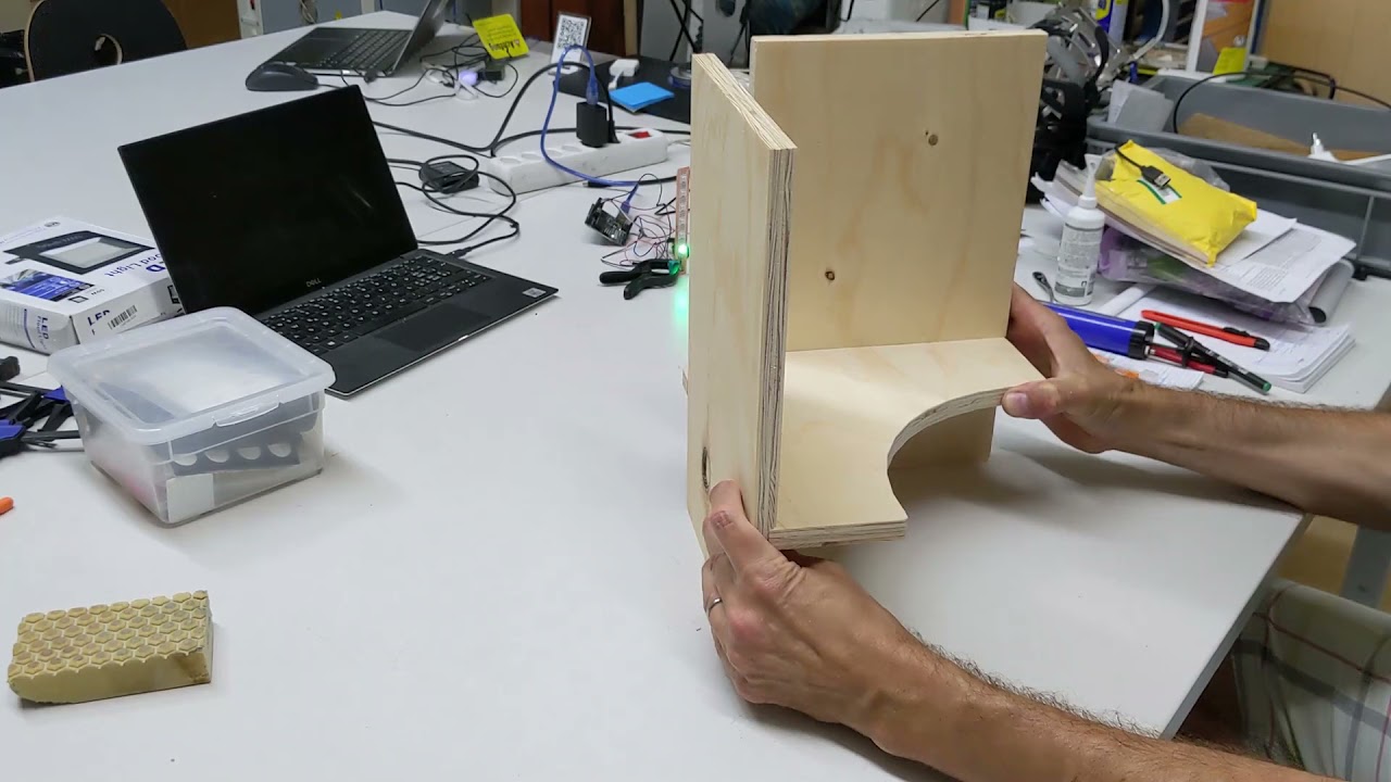

“Please design an over engineered placeholder for this bin and make shure the guys from the marketing dep get a couple of nice pictures!”
OK, here you go: [details]
[/details]
Is this your project? It’s very nicely done, I like how you used those pockets :+1: :+1:
A video of this build popped up on my instagram a few days ago and it made my day :grinning:
