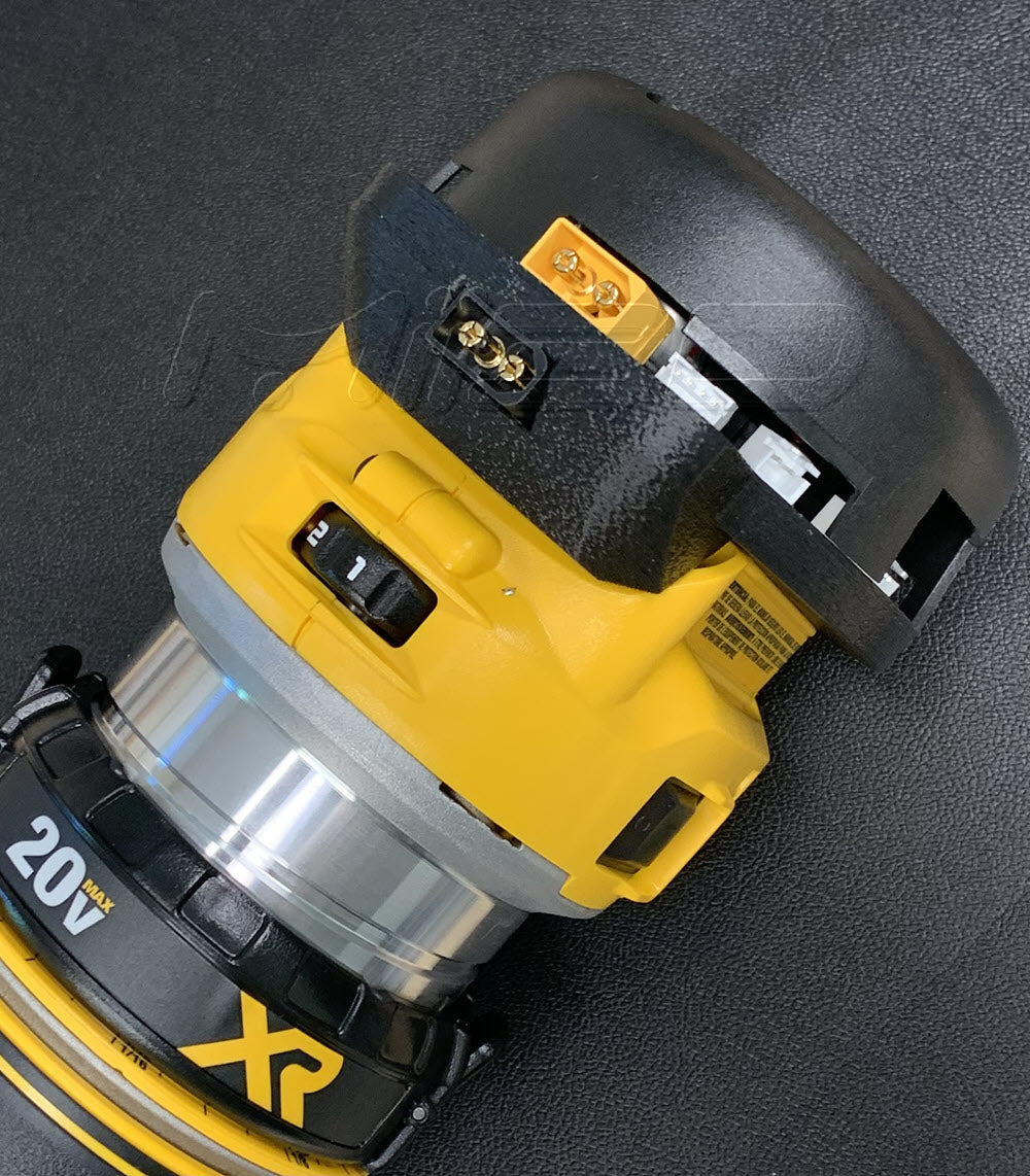

Hi, I have engraved a 6ft.x2.75ft ACM sign with a fullty converted 20V battery M-4.1

Could you explain how you converted it to battery ? Did you buy a battery router or is the battery powering both the router and the maslow ?
It uses a DeWalt DCW600 20V-XR Brushless Router. There are two 20V batteries, one for each the M-4.1 and the Router. I have designed a new M-4.1 controller mount that attechs to the DCW600 and two 20V battery docks. I wil soon make a 24V custom battery for the M-4.1 for it will run bit faster. Cut times will depend on battery size/capacity. not voltage.

If you feel like sharing in the printed parts thread I for one would be interested, looks like neat work!
Are you going to build the battery from cells, or use a couple of 12V tool batteries in series?
Im thinking about designing 24V-(6)_21700-5.0Ah cell battery case tower into a NEW linear bar tower.
