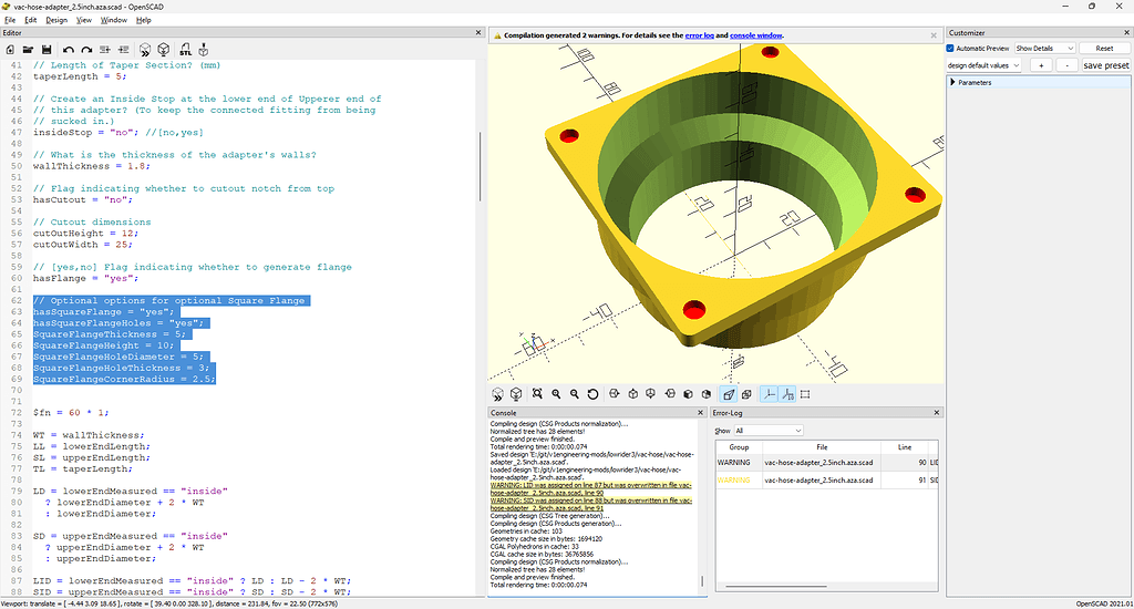

2.5", but… During my V1E LowRider3 build I discovered not all 2.5" vac hoses are dimensioned equally…
Ended up having to print an adapter so that my 2.5" vac hose would connect to a part someone made for their 2.5" vac hose.
Fortunately was able to find (thanks to Philipp on V1E) and remix a parametric/configurable OpenScad adapter, example…
https://www.printables.com/model/550066-lowrider-3-vac-hose-adapter-25-and-parametric-scad
Latest adapter shared on GitHub has optional square flange.
