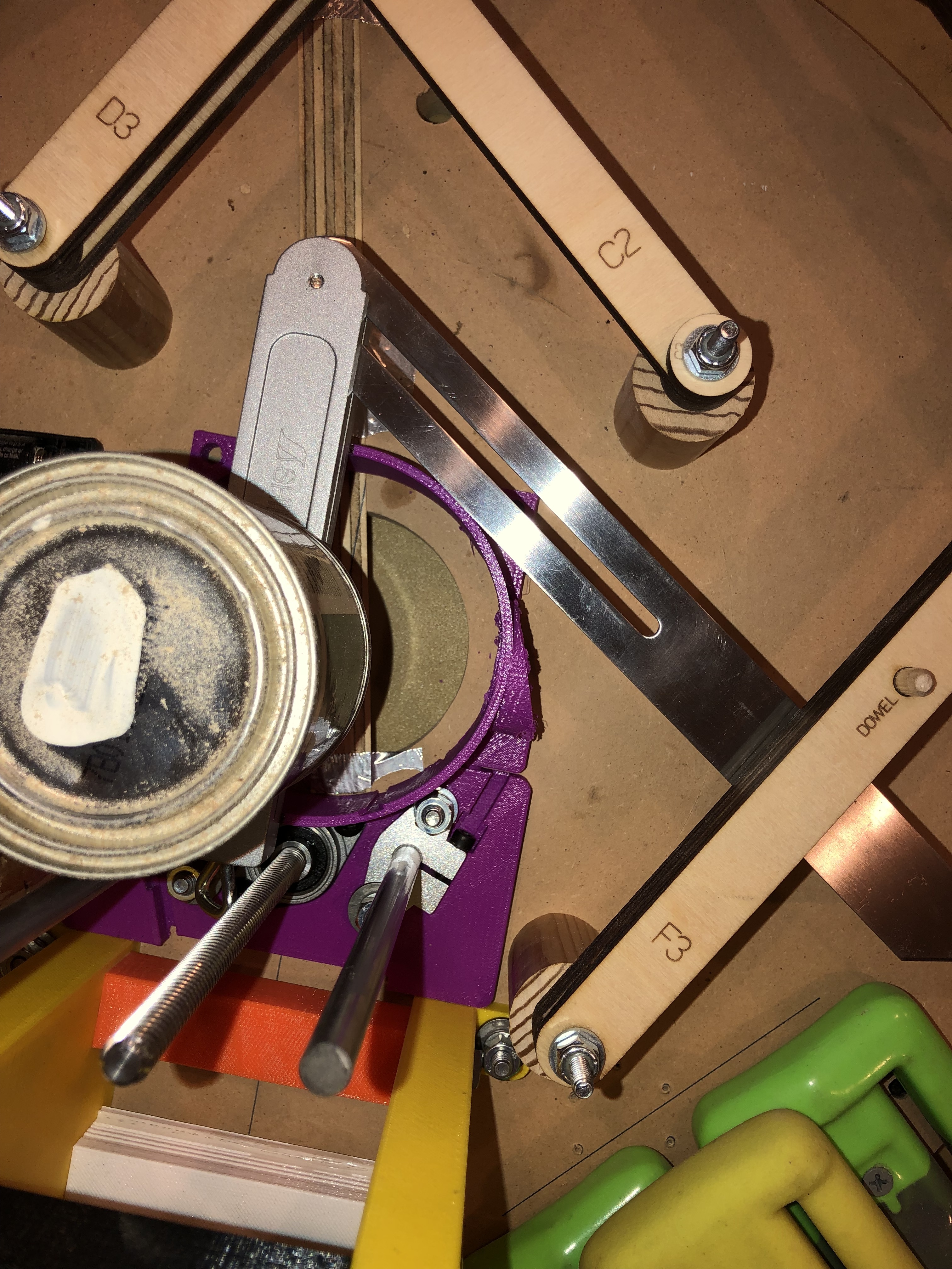

The first comment that I have with regards to your quick drawing is that the tube stub seems to be a tad short. I you insert a vacuum tube or extension, the it will protrude into the ring area, which is not good. We should lengthen that tube stub section.
I made a few tests and added some mockup pictures with different angles from 55 deg to 65 deg.
The first image shows the ring with the original dust tube cut off. The silver angle adjustment thingy (which is held down with a can) is set to 55 deg and tangent to the ring to move it as far from the z-axis base as possible. In the second image I am adding a piece of wood that is about as wide as the dust collector tube. The tube would clear the linkage kit post, but I agree that there is some conflict with the already installed z-axis base. So, 55 deg may not work.
Mockup 55 deg, no tube:
Mockup 55 deg, wood = tube:
I then increased the angle first to 60 deg and then to 65 deg. I think it would be best to keep the angle as low as possible since gravity pulls the vacuum hose and turns the sled a little to the right when cutting. I might be off of course, but intuition (and some basic physics) tells me “the lower the angle, the less the effect”.
At 60 deg, I seem to clear the z-axis base, which again requires the tube to be put as far from the z-axis base as possible.
Mockup 60 deg, wood = tube:
At 65 deg, we get even more clearance and we might even avoid my weights. But I rather rearrange the weights to keep the sled as “straight as possible”.
Mockup 65 deg, wood = tube:

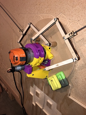

Update.
Some success, some setbacks. Here is my current status:
  1. The dust shroud seems to be fine. I installed it and is fits and clears. I needed to push it a little so the outer shroud that comes from the top slides by it. I just pushed the shroud a little to the side when fastening it on the sled and it seemed to work.
  2. The base mounting nuts prevent the maximum depth of the router right now. See picture below. I don’t think that matters much though, but some more cutting depth could be gained if needed. It could be that other conflicts exist (at the dust collector tube?), but this is the first one that kicks in.
  3. The clamp is too wide. Seems like my clamp is a tiny bit too wide. It does not clamp. I can still move the router around after the surfaces connect. (And yes, I removed all the grease.) Not perfectly sure what to do here. I could imagine to put a sticky material between the clamp body and the router such as (i) non-slip drawer liner, or (ii) strong double sided tape. The third alternative would be to measure really carefully and reprint with a scaling factor to get it to fit. Could be a precision thing of my printer. Suggestions are very welcome.
  4. I have cut the front top dust shroud with my scroll saw so that it clears the new dust collector tube. I think that will do for now. Once I get my clamp going I’ll try it out and make suggestions to design a real part.
All in all, I have to give many compliments to @rwales and supporters (minions? :joy::joy:). Excellent built, well thought through, lots of attention to small details and making a really good impression on me. Somebody has some good OCD going there. Keep it up.
Just a few little things to overcome for me to be in business.
Looking forward to your suggestions.

@rwales: I found some time to get back into the garage and work on those issues.
  1. I didn’t find it that hard to make the dust shroud fit. Not sure if the complexity of a drilling template is worth the time required for the install. In my opinion assembling it last and fastening it with some beefy screws from the top that do not penetrate the entire sled seemed to be working well.
  2. Fixed. I used a shorter screw, moved the spring washer to the underside of the sled, and used two leftover square nuts which were much thinner. It doesn’t seem to be a limitation any more after I mounted the sled as you described in your post.
  3. I used two strips of a soft rubbery stuff that I had laying around on the two outside clamp portions (purple). The yellow clamp portions seemed to be a little tighter. Anyway, got it together just fine and nothing is moving.
  4. Picture from my “adjusted” dust sleeve attached. Sorry about the bad lighting. I’ll have to wait until the weekend to test it out, but I hope it will work.
I also did:
  • adjust the pitch for the z-axis in GCode to 8mm and it worked well.
Other than that, I still need to:
  • Rearrange the weights at a minimum on the right side.
  • Design and print an adapter dust tube to allowing connecting to my hose. => Could you send me the dimension you used for the dust tubes? That would save me some time I think as the original dust tube connected well to my hose.
  • Test it all.
And then last not least I would like to:
  • Come up with a motion stop system when the sled is too high or too low. I probably would put out an independent thread for that, if others are interested to pitch in.
Feels like I got a lot accomplished with your help in just a couple of weeks. Great feeling. Can’t wait to make shavings again. Thanks for the great support.
Tschöhö
Superbender
P.S. I have the original dust shroud that I can volunteer to anybody who wants it.
I forgot to add pics.
Clamping fix:
Dust shroud fix:
Overall look:
