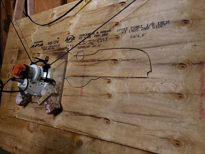

I finally got back in the shop and started getting the machine up and running again. I got this rig together and at least zeroed.
I used the original dust chute and the angle puts it right into the weights, need to print a newer version.
Z range of motion looked limited and I made some adjustments on the router location in the clamps and it looks better.
Maybe some cutting tomorrow.
due to the weight of the 10 lb ridged router any design needs to have support rails as far apart as possible to give stability.
for c beam designs this means using the outside 80mm wide edges instead of the inside 40mm wheels.
for 3d printed designs like this it means having the two solid rods spaced out at 3 and 9 oclock instead of 5 and 7 o clock.
By making the z axis more stable you can cut deeper per plunge.

If you bought the kit in the BOM, it should be 8mm. The build instructions mention it towards the very end.
Oh, and on Z range-of-motion, I’ve measured and you can get about 1" if you optimize the placement of the rings on the router a little bit. If you plan on cutting deeper, you might need to try a different kit.
