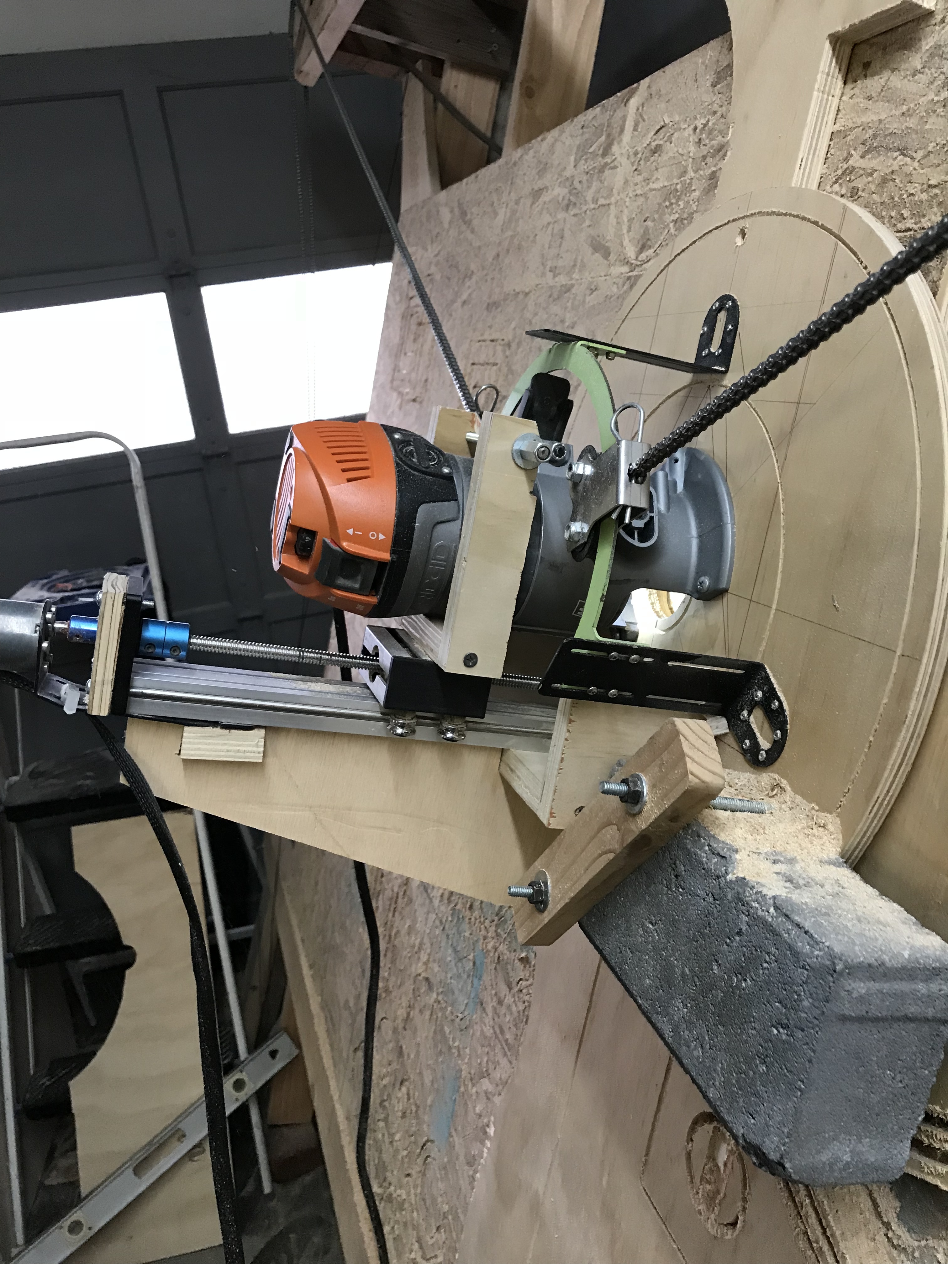

Dude, that look cleaner than mine. I ordered the 100 mm and they sent me the 300, it is a skydive tower on my sled. but, it works. I do have play side to side on my rail. how did you get the bearings tight to the runner? And where are the files you cut? Mine barely fits in the ring.
What kind of accuracy have you been having on your stock z axis? I think I’ll definitely want to build something more like this long term but I am curious as to other people’s experience with accuracy of the z axis using the rigid base.

Well, I bit the bullet and ordered the z-guide from the beginning of this thread. I also ordered their 500w spindle with rpm controller and collets for 1/4” bits and a range of metric sizes as well…
Ok, so I bought the new Z axis, fit it and, built a holder for the router. It had too much play for me. I reinstalled the router base, cutting off about .5 inch from the top. Cut down my holder to do the lifting and it is pinch fit at the top of the router. The bottom rides up and down in the base. Can use it for dust collection too!
Nice build! After building it, what length would be the shortest to work? 100mm?
If you use the base like me, a 200mm likely. I think @Onelonedork used a 100mm with his.
Is that the same 200mm one from banggood? If so, do you find the rails on yours also have no slop and what part(s) did you use to adapt the z motor to the setup?
I ordered the 200 but they sent a 300. But yes. They have very small “slop”, but too much for me, so I put back the base to hold it still. I used the stock z motor, with the stock z shaft adapter. I cut the small plywood square to use for the adapter guide. Then used a wood pin to connect the two adapters.
