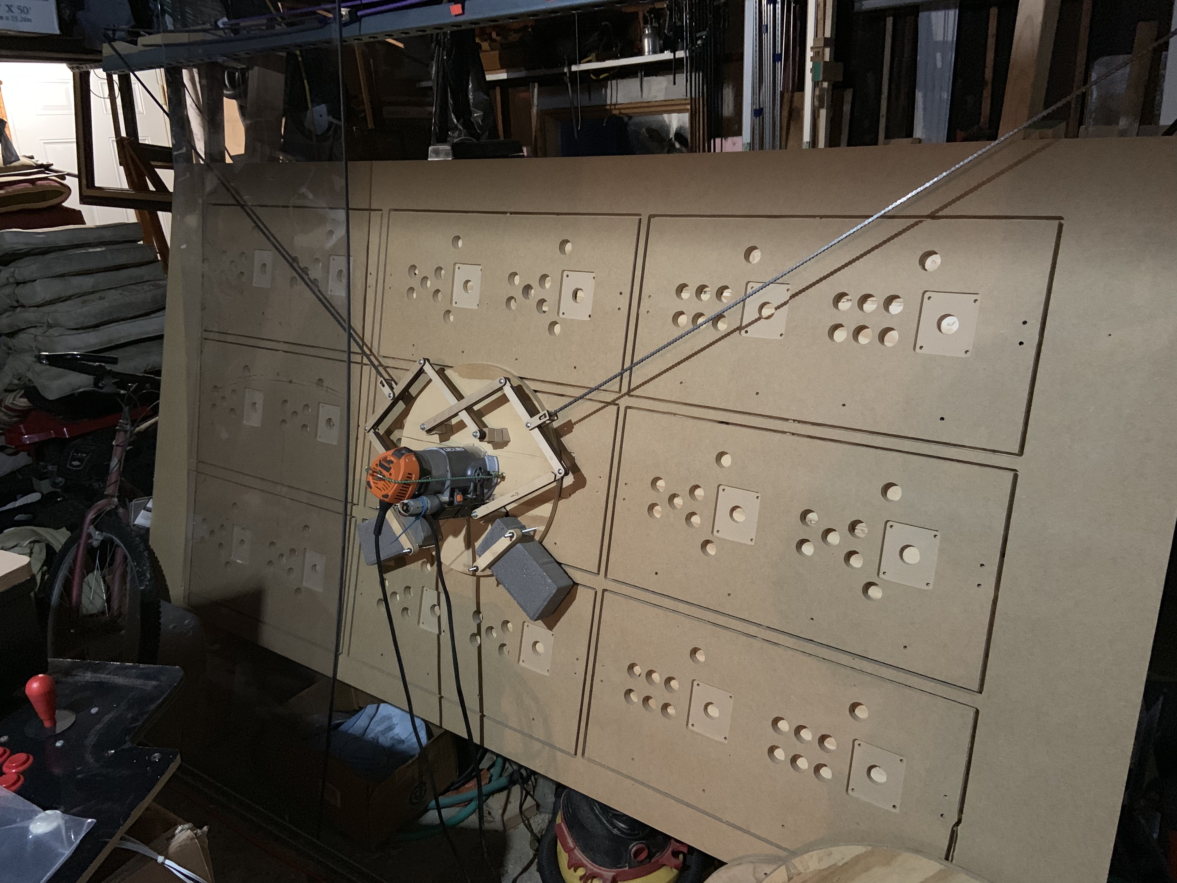

I do have progress though:
Haven’t checked the button holes or stick pockets, but the outer dimensions are dead on horizontally and only short by 1/16ā€ vertically. This one may be usable. Also need to change a workflow thing

Turns out the need for control panels is even greater than I expected, so I had to do some workflow testing and other nonsense.
I messed some stuff up and ended up losing a control panel, and the bottom right was just me testing tolerances. I actually know what to do with this now and should be able to get five konami panels out of a sheet easily.
(And yes, there are calibration benchmark squares there. My most recent benchmark was 0.78 - 0.13)

I’ve been on weather/light hiatus since November. There’s a .svg in my last post that you can use to generate your own GCode though. The squares around the bigger holes need to be around .30ā€ deep.
I’ve been getting different panels to rebuild from and I’m HOPING to do a test cut with what I’m making soon. The rare days where the weather broke in the last few months were all consumed by more important things.
Excluding the big sheet of plexi, my Maslow has been sitting like this since October 30th.
That older design I posted was actually used on some machines that were sold out of Columbus not too long ago. The panels I cut out and t-molding routed ended up being around 97%-98% accurate.
Newer build I have ready for test is a bit tighter on locations and has marking for where to place the clamp brackets.
