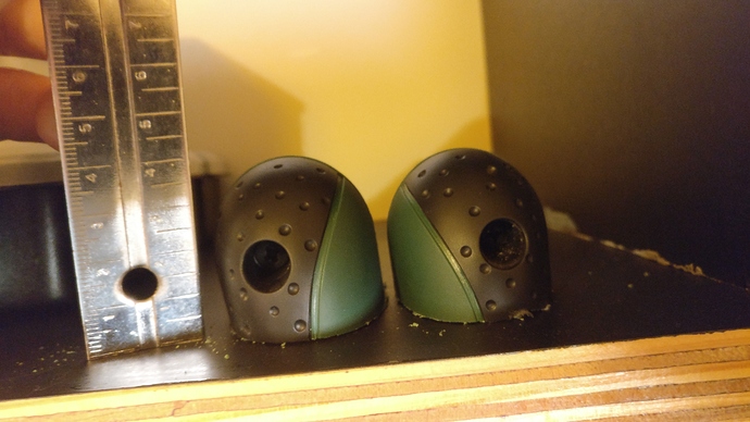

Cut ~40mm off the handles on my bosch 1200 ae. Works fine with the standard ring kit! The cut is at least 10mm away from any wiring or vital components in the handles so there is definitely room for error. This is far easier than cutting the entire handles off and having to rewire the switches. Can be done in ~5 minutes, if you’re looking for a solution for using this router with the standard ring kit, give this a try!
I will model some 3D printable plugs for plugging the holes in the bottom of the handles soon. Will post an update here when I do so.

I went all the way and took the full handles away on mine - a pity since it’s not that much that is needed I see.
How much of the interior parts did you remove? I just mounted the shaft couple on the tube inside but I fear that that has cost me some height if I ever need it
Damn I now see why people take off the whole handles. I didn’t realise but the bolt that holds the bearings on the ring kit sticks out, causing me to lose ~5mm of adjustment. Not the end of the world but something keep in mind.
With the interior parts, I went all the way and took the whole green shell off to remove everything. I now have up to 55mm of adjustment. Interesting to hear your method. Please, test to see how much height you get, because your method might be a good option for future users. Removing the whole green shell is not fun, especially on a brand new router.
