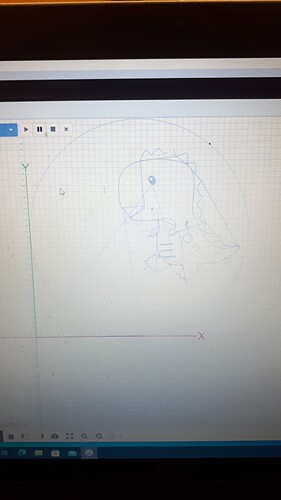

Hi,
I traying calibration cncjs. But my cncjs not haw any configuration or calibration button. Hawe many ideas? I tray reinstal cncjs but program not hawe any calibration or configurations buttons.

But where the calibration buttons disapiered?
in your screen shot above, you have to select the serial port and actually open the port before the calibration button will appear, but @dlang is correct. cncjs does not support the maslow, you must use the latest generation of if that is called makerverse.
