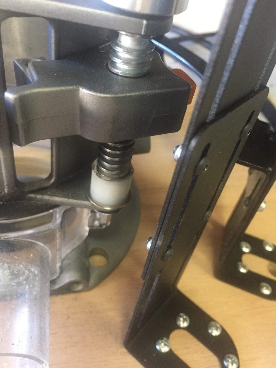

The other, and maybe related issue is the z-axis. The first cuts are about 0.2 inches (supposed to be 0.25), and the last are about 0.33 inches. Also, the router got stuck down a couple of times near the end, but (to my surprise) recovered. Here’s some pictures of that:
I’m using a Ridgid 2200 and modified it with a washer and bushing as per: Inexpensive add-ons for z-axis slack imprecision
I also added a strong bungee cord over the top like this:
One obvious issue is that the bushing came off at some point, so maybe that explains all or most of my z-axis issues.
I’ll have to get some stronger glue.
Any help resolving these issues would be greatly appreciated.
Be careful not to put too much force on the top of the router with the bungee as it will cause your tab holding the router to pop out and your router will plunge all the way into your piece.

I would recommend adding the bushing to the other side of the router tab so you dont bottom out.
Mccand, thank you for those tips.
I’ll try a lighter weight bungee. Usually, it’s just the force of gravity pushing down on it, so that makes sense.
I’ll try an 1/8 inch depth.
I actually did try with the bushing on the other side, but was worried about it topping out. Maybe I’ll cut it in half and split the difference?

As others have offered I suggest putting the bushing on the other side of the router tab, be sure your travel height will not run the bushing into the top of the carrier. I tried several glues and ended up using JB Weld.
The casting of the router base is fairly rough (is was not originally designed to move up and down on the fly). I sanded the entire inside of the router base and the alignment pin grove to remove all imperfections and finished with 600 grit wet/dry sandpaper. I sprayed the router body with dry graphite lube and it makes the z axis move like butter and has been durable.

I decided not to be wise to break the rules, so I did put the bushing on top, also I got a nice beefy steel bushing (actually a lock collar, which I took the set screw out of), and used JB Weld SteelStik epoxy putty to put it on. I tested it with a pair of pliers after it cured (just 1 hour) and sure enough it was stuck good.
A while ago I noticed that the channel for the pin on the router was kind of rough, so I took a file to it, and smoothed it out.
I’m running a second test with the this bushing fix and g-code fix (see below), and so far it’s looking great. The z-axis is tight–I’ve been checking the depth as the test progresses, and it’s been locked on 0.25 inches across the whole piece. Also, with the g-code fix, there’s no burning, and the bit’s staying sharp. I also took Mccand’s advice and used a weaker bungee across the top of the router, and making two 0.125 inch passes rather than a single 0.25 inch pass.
