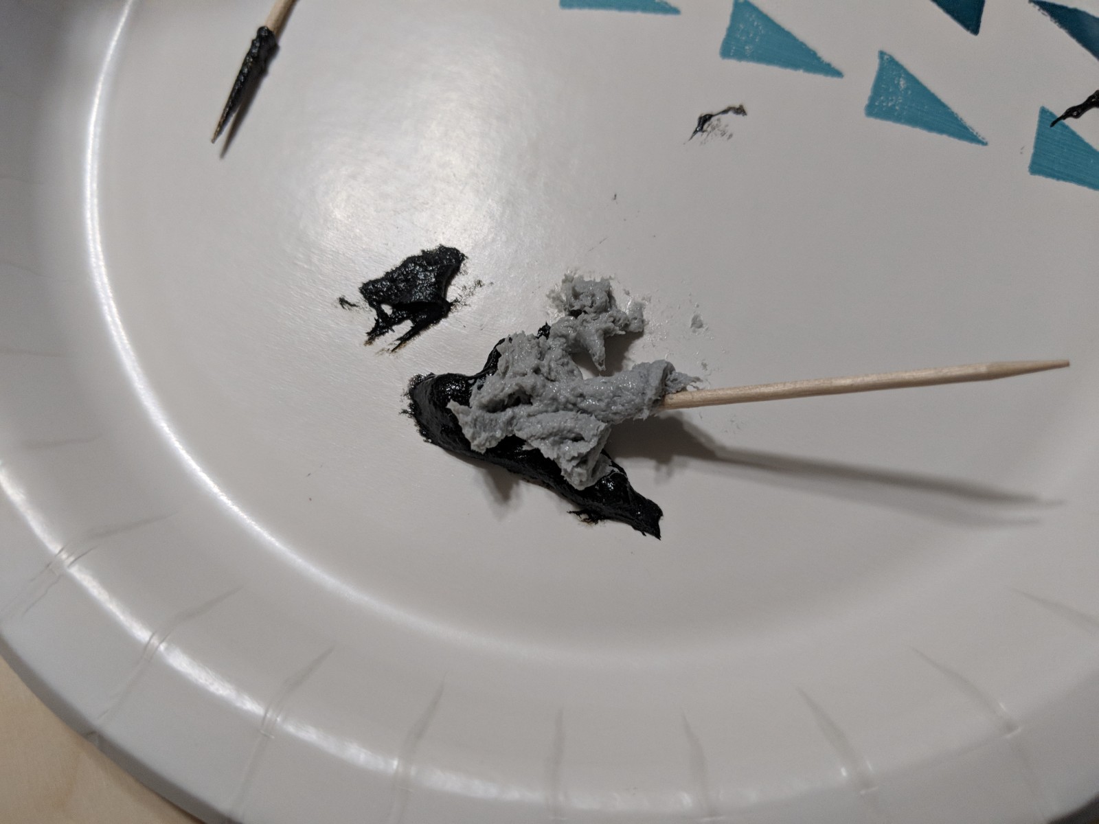

Prepped the worm carrier for the bushing as seen here http://maslowcommunitygarden.org/Inexpensive-add-ons-for-z-axis-slack-imprecision.html
My choice for bonder was PC-7, mix black and grey. Kindof a paste no runs.
1/2 inch bolt with some washers to bring the thread in play. Packing tape on the bolt to prevent bonding. I assembled the clip and bushing with PC-7 on the bushing, put the nut on top and tightened it down.

Well PC-7 did not stick to the magnezium, don’t use PC-7. I coated 1/2" bolt with bees wax and used super glue gel to stick the bushing on the carrier. We’ll see how that holds up.
Update, wanted to cut tonight but the superglue failed on assembly of the router. Trying JB weld now…:face_with_symbols_over_mouth:
I used gorilla gel glue and so far that has held up to about 30 hours of use with no signs of problem. In my shop I also have a handle that is gorilla glued to 2 cinder blocks and has lasted for over 12 years. So that is my vote! GORILLA GLUE!!!
Edit: Just as a side note, I used pam on the thru bolt so that it would not stick. I glued it after work one day and then took it in to work the next day. (glued for only about 14 hours)
Hope this helps.
Thanks! I saw that GG was used in the “Inexpensive fixes for z-axis” article I’m just not a big fan of PU glue and couldn’t imagine it working that well on metal. If JB fails me I guess that is the next step. When I glued with JB weld I put some thin scotch tape on the 1/2" bolt and that seemed to work well.
