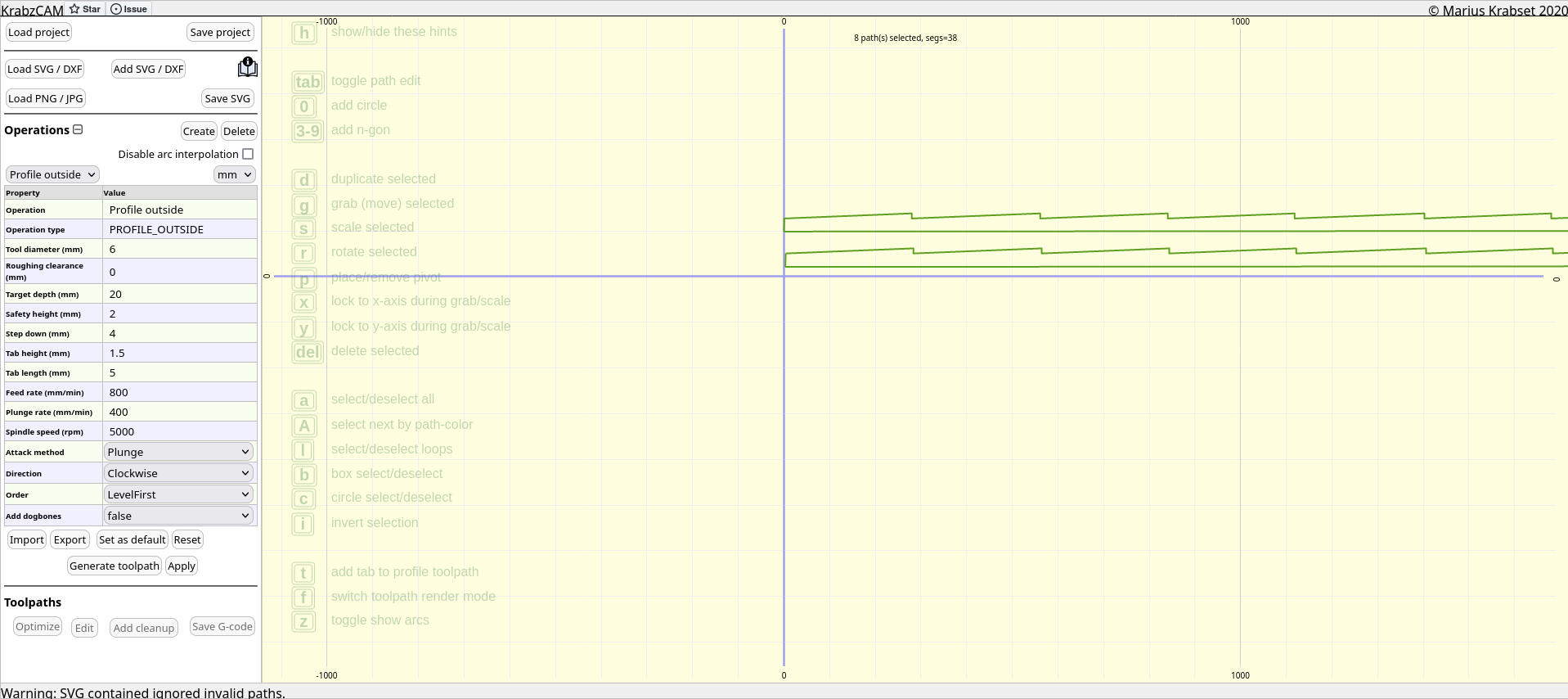

Hi, In Linux, using either LibreCad (v2.20a, DXF) or Inkscape (v1.2, SVG) to create a simple line drawing, KrabzCAM (web, FireFox 102.13.0esr 64-bit) always offers “Warning: SVG contained ignored invalid paths.” and only 42 bytes of G-Code are created with no paths or cuts. The manual doesn’t mention this warning, and it seems more an error, as no working code is ever made and the message appears for both DXF and SVG files. I’ve tried grouping/not grouping, breaking/bursting,objects to path, saving as inkscape svg, plain svg, and optimized svg from InkScape-all fail with the same warning when I load the file into KrabzCAM. The web offers no suggestions that I can find.
Any suggestions?
Thanks you for reading this and for writing KrabzCAM.
Hi, I’m not sure what the exact problem is.
Could you please post an svg sample file?
-Marius
Hi,
Please find below, in a total of three posts, a screenshot of the KrabzCAM web page after loading the SVG (the warning is in the lower left corner, the “8 paths selected” message is at the top center), the 42 bytes of G-Code made from that SVG, a screenshot of the LibreCAD DXF, the contents of the DXF file (a long file), a screenshot of the InkScape SVG made from the DXF, and finally the contents of the SVG file.
I hope this helps.
The G-Code made from the SVG:
