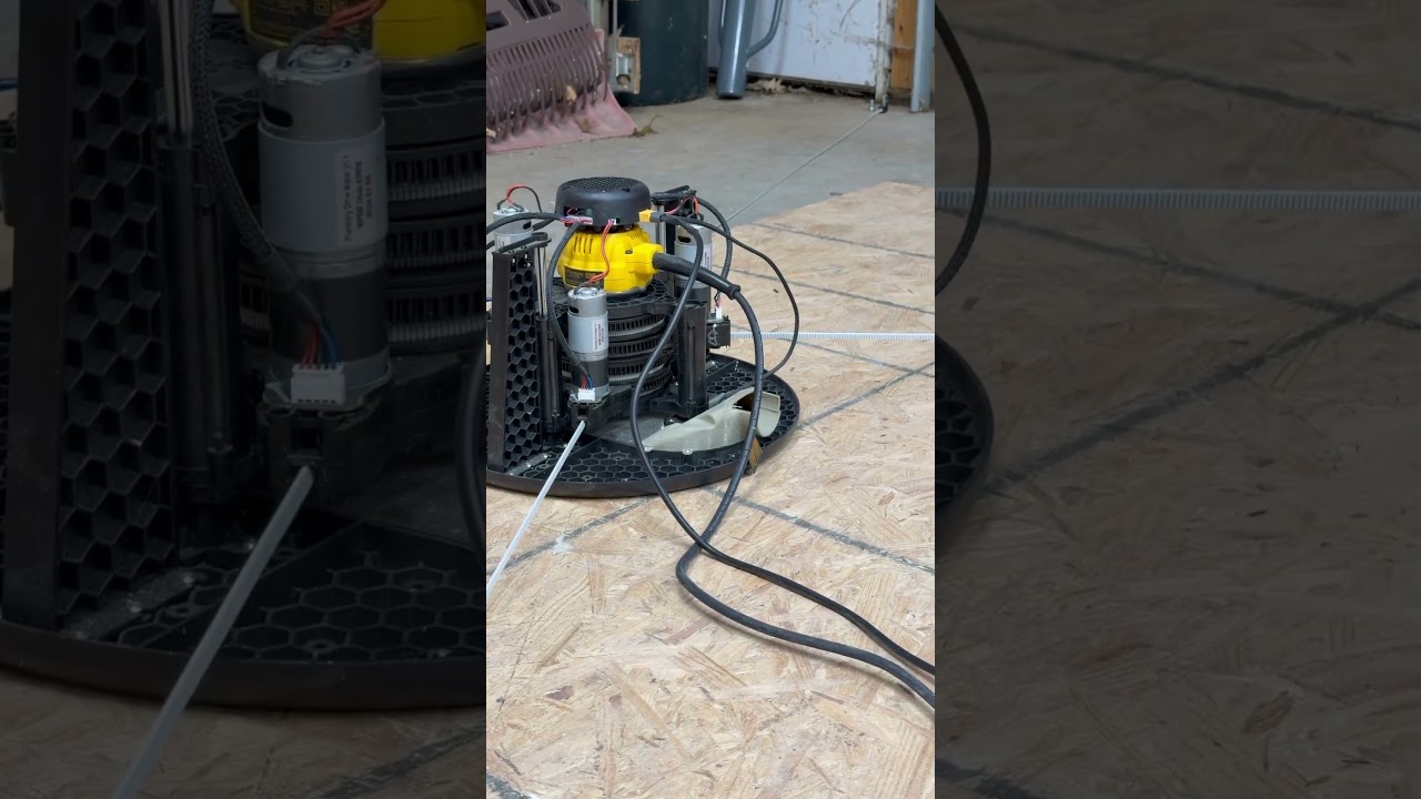

Losing belt position - w/ video - please help! :)

@Bar What size grid should I try? 5x5 700x700 doesn¢t seem to be doing it. The frame is about 5¢x10¢ with a standard 4x8 as spoil board.
5x10 is very short for the width, see https://lang.hm/maslow/maslow4_frame.html
and put in those values. your height in the green is only ~400mm tall, you may
be better going with 5x8 (but you really need to get more height for your frame
if possible)

hi, so I gradually tried a 7x7 grid with dimensions 1600x800, both forces 1500, and it seems that the belts are no longer loosening, however the accuracy is 3-5mm shorter at 1m in the X axis.
fitness approx. 0.8
so I also tried with 9x9, 2000x1000, both forces 1600. The belts do not sag, but the accuracy is still with some scale. 3-5mm shorter at 1m
fitness was approx. 0.65
I had the Z offsets set.
Maslow-serial(6).log (56.6 KB)
I wonder if it will be accurate after calibration, or will I always have to scale it up and fine-tune it on the scale myself?

Alright, I tried anchoring straight into the barn floor. ‘Find Anchors’ is running but some of the belts weren’t tight during calibration, consistently it seemed the bottom left belt (if it were vertical) didn’t pull tight multiple times.
We’ll see if it finishes calibrating. Frame is much closer to 13’ by 8’ now.
I believe my “frame” should be about 2438.4 mm by 3962.4 mm. It’s currently running a 3x3 on 400x400. If it actually finishes i’ll try again 7x7 at 1300x800.
if you have a belt that is not pulling tight at even a few of the points, the calibration run is not going to be useful
you can increase the calibration current limit, or you can take apart the problem arm and figure out why it’s taking more force to retract than the other arms.
Well the belt broke on one of them… off to Amazon.
Convince me I don’t have some variation of this though:
Bottom left motor not working during calibration vs bottom left motor doesn’t retract? The 4.0 wasn’t this bad, just lost signal because of the old cables
