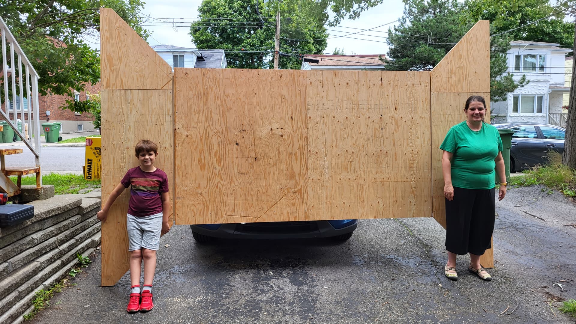

Working on making my frame with my dad now, decided to go with 3/4 inch finished pine and all 2x4s just to make sure it was sturdy and looked appealing enough to me no offense to osb users, just love my plywood
I love me my ply too - I had the OSB on hand that day and I went with it.
You and your Dad are crushing it, beautiful build, I love to see it.
Oh yea its always good when you got it on hand, oh yea one of the other reasons I didn’t choose it was because I also just don’t like how screws interact with it, and thank you, I appreciate that i cant wait to update you on the build, and thank you for providing us with the design I love the hourglass design. Much sturdier looking and just really a lot more pleasant in functionality looks and accessibility aspects than the other frames I’ve seen, I’m a big fan of it
