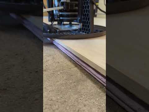

So this is supposed to make a 40mm square in 200mm and up 200mm, than a 100mm diameter circle.
Fusion simulation looks good
NC Viewer 1.1.3 looks good
Well that foam bit is toast. In all it’s spark oh shoot glory.
Now the interesting piece here. After pulling the plug and looking at the coordinates reported by fluidNC. What is expected by the gcode is not correct. Why in the heck would it report -28.12 when the total negative value is Z-3.175

Since I’m a glutton for punishment, let’s have another go. G54 is getting set.
I think I figured it out. Line 7 of the gcode G28 G91 Z0.
(Test1)
(T1 D=6.35 CR=0 - ZMIN=-3.175 - flat end mill)
G90                           (Absolute positioning)
G17                           (XY plane)
G21                           (Set to metric system of units)
G28 G91 Z0              (Move straight to the reference position relative to the tool's position)
I have to pull the arms back off as the second from the top got wrapped in the gears again…
What I think is happening here is on a normal gantry machine you run a homing cycle. Well, Maslow doesn’t have a homing cycle defined. $H actually throws an error. When a user jogs to the start point and sets G54 relative to the machine position.
On Maslow you automatically assume you start with Z all the way down. There are no limit switches, so this is the work around to “homing”. If “home” with Z down, add slack to pull pins and load the router bit, and set the router height using a 123 block. I’m now 28.5mm positive, well I can’t go to Z0 relative to my current position without driving my endmill 28.5mm negative into certain death.
So in this case to the TLO would need to be set G43.1 Z28.5. It doesn’t look like Maslow supports G43.1 or $#.
@bar does that make sense?
I think so? You might know more about this than I do. I just press the define home button in the z-axis popup at the top surface of the material and that usually works, but there might be more complicated situations that I’m not aware of which might not behave as expected

Here is what I ended up measuring towards the end of the work area. The square came out great, but the circle is shy of 100mm if I added that right.
Understood, I just saw it was updated 41 days ago. Hey at least we can get it updated to include helical moves.
It would be better to fork it and make a maslow 4 profile (or find a fluidnc
profile and use that), there are still the old maslow machines around, we don’t
want to break them.
Well off to the races I go. Hoping 3" from the end of the ply will be okay. Suppose I’ll find out soon enough.
Bold first cut!
Yeah, I need to be able to do full size sheets. I think I’ll have to make some blanks that I can slide in along the edges to allow Maslow to get closer to the ends.
@bar with the vacuum on it almost functions as a vacuum table holding the router to the work piece. The whole work piece flexes.
This makes me wonder If I should have the Vac on during calibration as well. since its going to add to the resistance.
Fusion estimated 3.5 hours. 5 hours later, I’ll have to setup a machine profile to dial that estimate in. I can’t cut the tabs free at the moment, but it looks pretty darn close to fitting.
