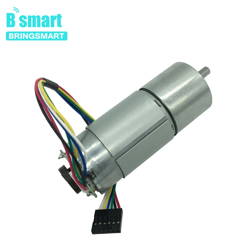

z axis motor about 80 to 100rpm will work much faster than the original 12rpm maslow motor

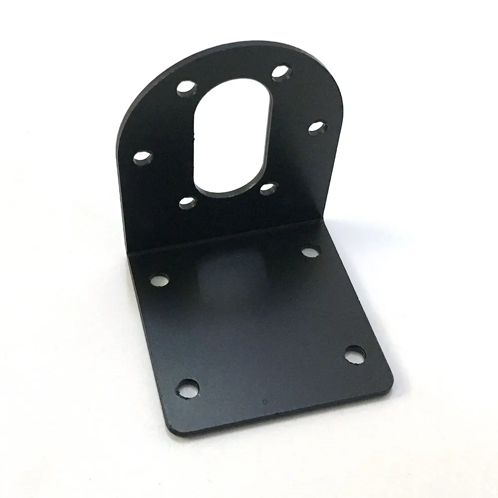

and the last thing you will need is a 37mm motor bracket and some screws to attach it to the z axis.
you will need to make some sort of plate to attach the motor to the c-beam
i have not figgured that part out yet, but it shouldnt’ be hard.
is one option but it’s rather expensive. a scrap piece of aluminum sheet metal could be used. as well
