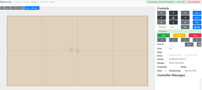

@madgrizzle , I installed Webcontrol 0.923 Windows64 single file. It opens in Chrome and looks great. I was able to import the groundcontrol.ini file and all my settings where imported.
But when I try to import a Gcode nc file it does not show on the screen. I go to Gcode, select upload, use browse to select the nc file and press submit.
Then I go to Gcode select open and select the nc file which I uploaded, and close off with submit.
However I don’t see the shape on the screen, when I select Gcode, View/Edit I see a lot of Gcode lines. So it must be there somewhere.
I’m afraid I must be doing something very stupid but I can’t figure it out.

Well, it shows up on my screen.
So… what browser are you using?
Ah, I didn’t read carefully… Chrome…
So what’s weird is that your display looks a bit different than mine. My “board:” button is blue and I have a tan background where the board is. I did some testing and it looks like there’s a bug somewhere maybe with board data causing the javascript to crash… that would stop the display of the gcode. I’m looking into it, but I suggest trying to restart webcontrol. What version were you using before you upgraded to 0.923?
My board button is also blue when I switch to a tan background. (See screenshot)
This is my first try with webcontrol, I am using groundcontrol V1.26 with no problems.
This morning I started up webcontrol.exe but with the same result, nothing shows.
Ok, I’m pretty sure it’s a JavaScript issue related to the board management aspect. I’ll put out a new release today with something that I think will fix it…

New release hopefully fixes the javascript issue:
