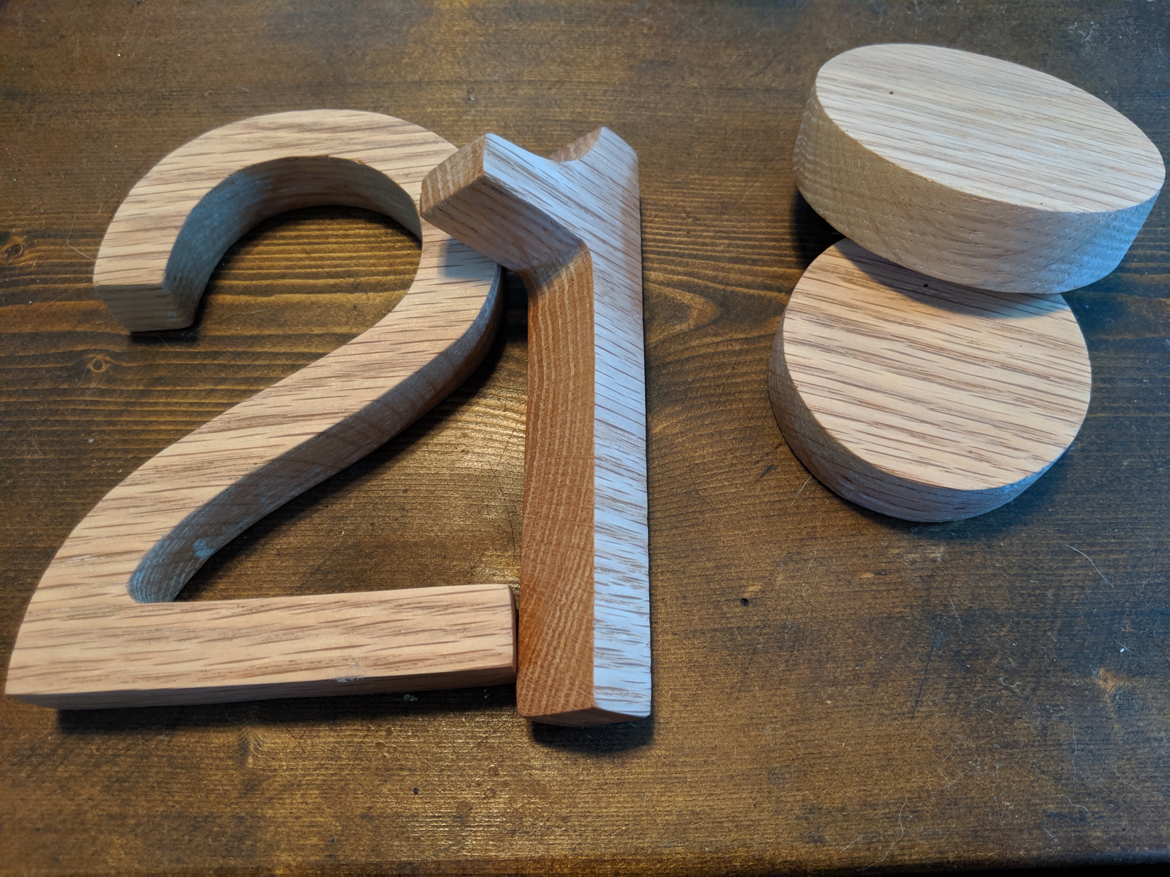

First cut in 0.75" red oak
Nice!
I’ve been wanting to cut solid hardwood. Can you tell us about the experience (bit type, passes and depth, speed, noise etc)? :slight_smile:
This was actually much easier than expected. I used 1/4" up cutting bit (this exact one). 12 ipm surface speed with 0.25" cutting depth. 7 ipm plunge depth. I use a bosch router with variable RPM which was set to ~20,000rpm (setting 4-5). Noise was a bit louder than usual but I tend to adjust the RPM of my router to find the “sweet spot” when cutting. All and all, the settings were not much different than what I use for regular plywood, but check out that grain!

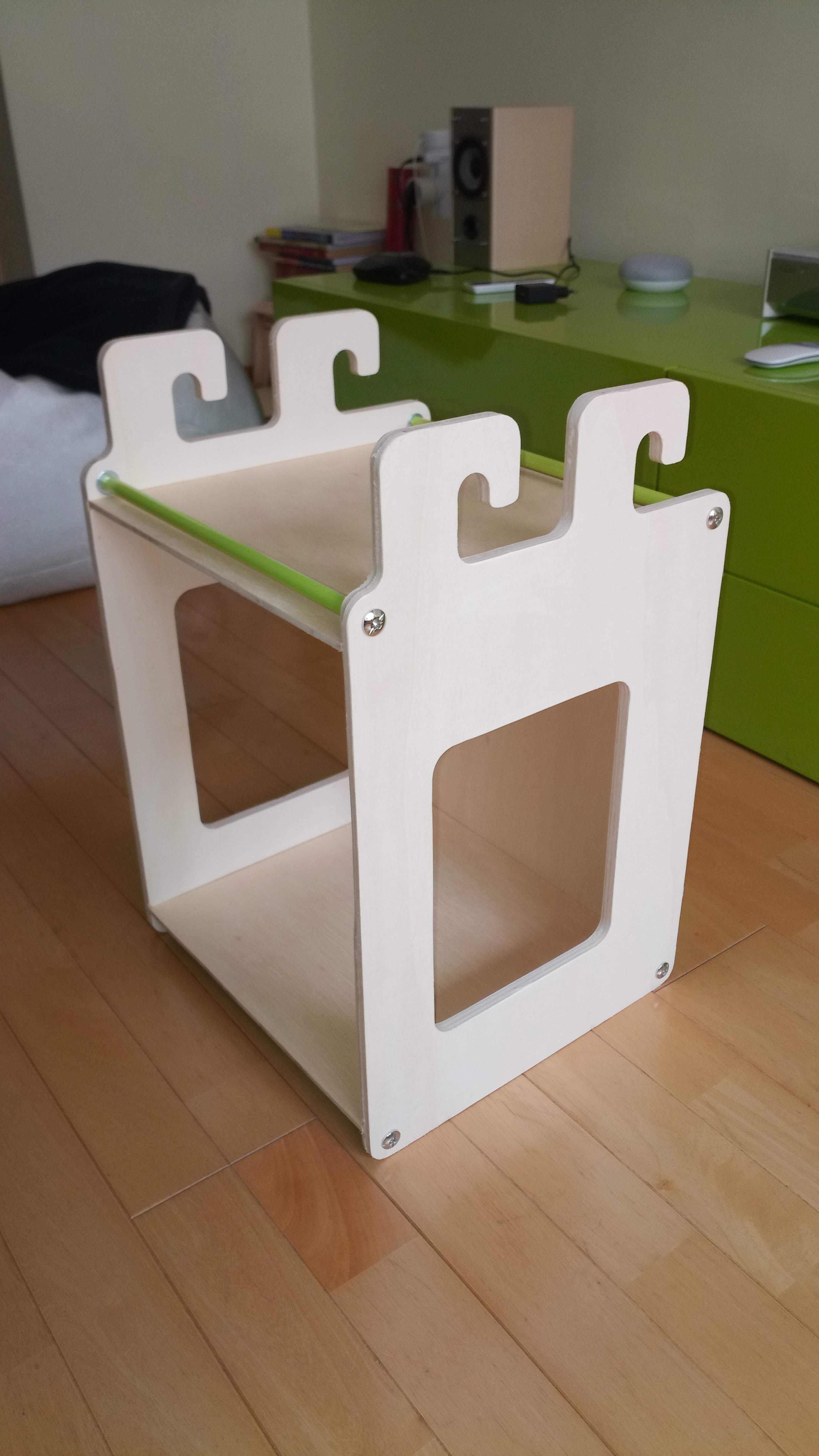

Table for the wife based on the Opendesk Canteen design.
Opendesk stopped sharing downloads so I had to recreate it in Fusion360.

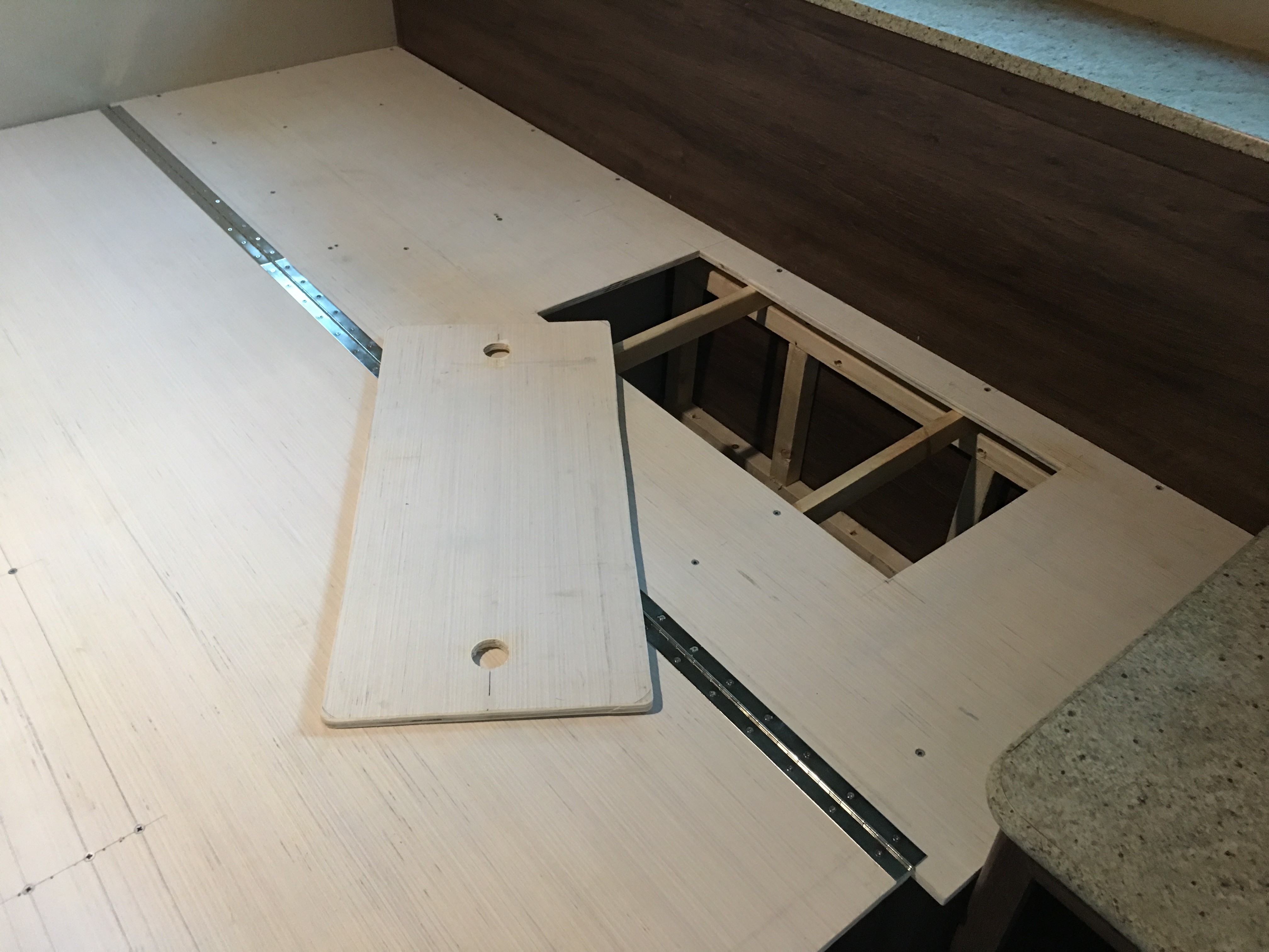

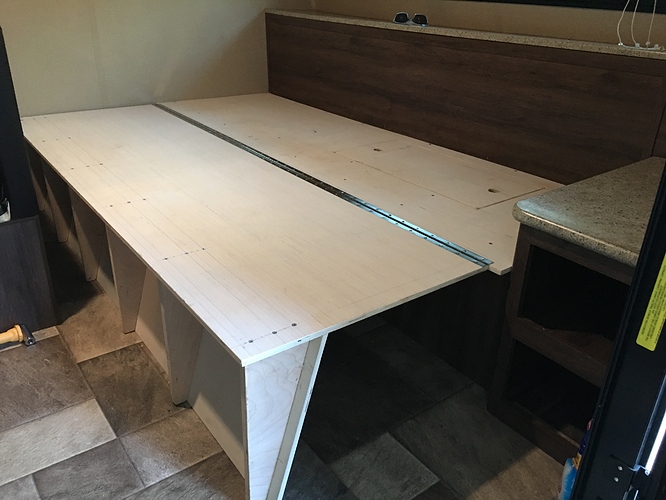

I converted this area into a sofa - couch conversion. I had planned to use the cnc but the cuts were pretty straight forward.

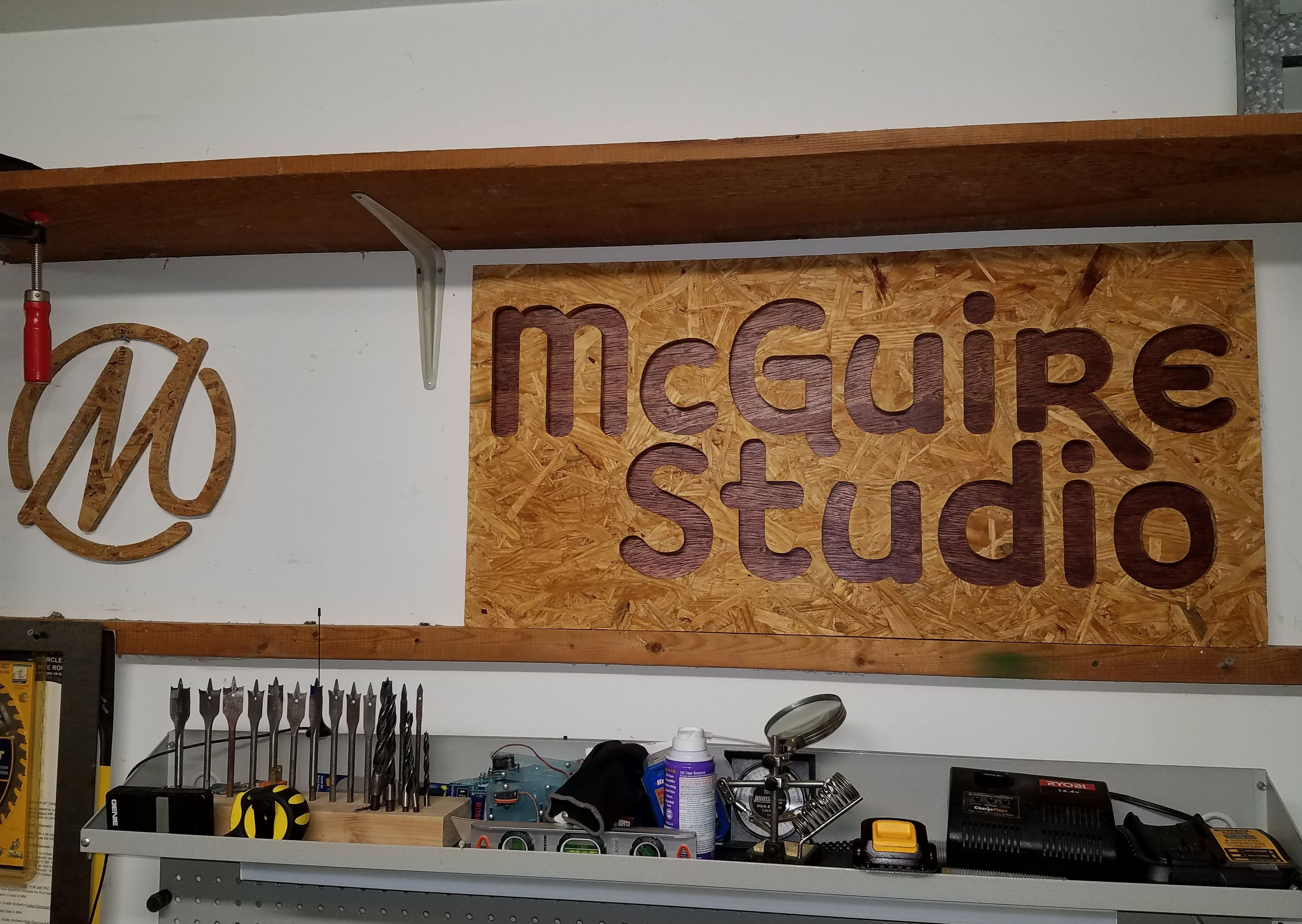

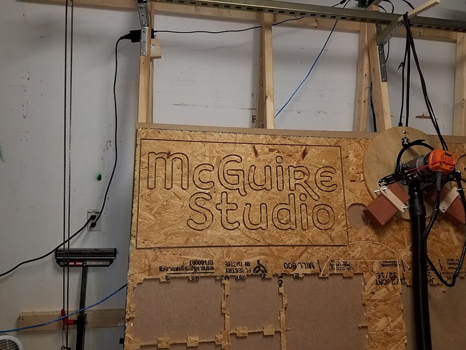

A sign for my garage wall.
Font: Kingthings Hand downloaded from https://www.1001freefonts.com
Still undecided how to paint it…
Edit - All made from scrap pieces. The face is 1/2 in. OSB, left over from my Holey Calibration testing and running a box generator from Easel. The background I used a piece of 1/4 in. underlayment that I slapped on some dark cherry stain on to give it some contrast…
