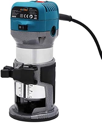

AEG and Ridgid are just different brands for the same hardware. buy a $100 makita or a $40 makita clone and take the money you save and buy a dedicated Z axis and router clamp. the Z axis hack on the AEG/Ridgid is the most complained about hardware on the entire machine. Best to avoid it to begin with
https://www.amazon.co.uk/s?k=katsu+router&ref=nb_sb_noss_2

THE makita always comes with standard base, the plunge and tilt bases are optional and not needed
ok great, so unless thunder strike it will be a Makita then !

thsi one is good value for price
