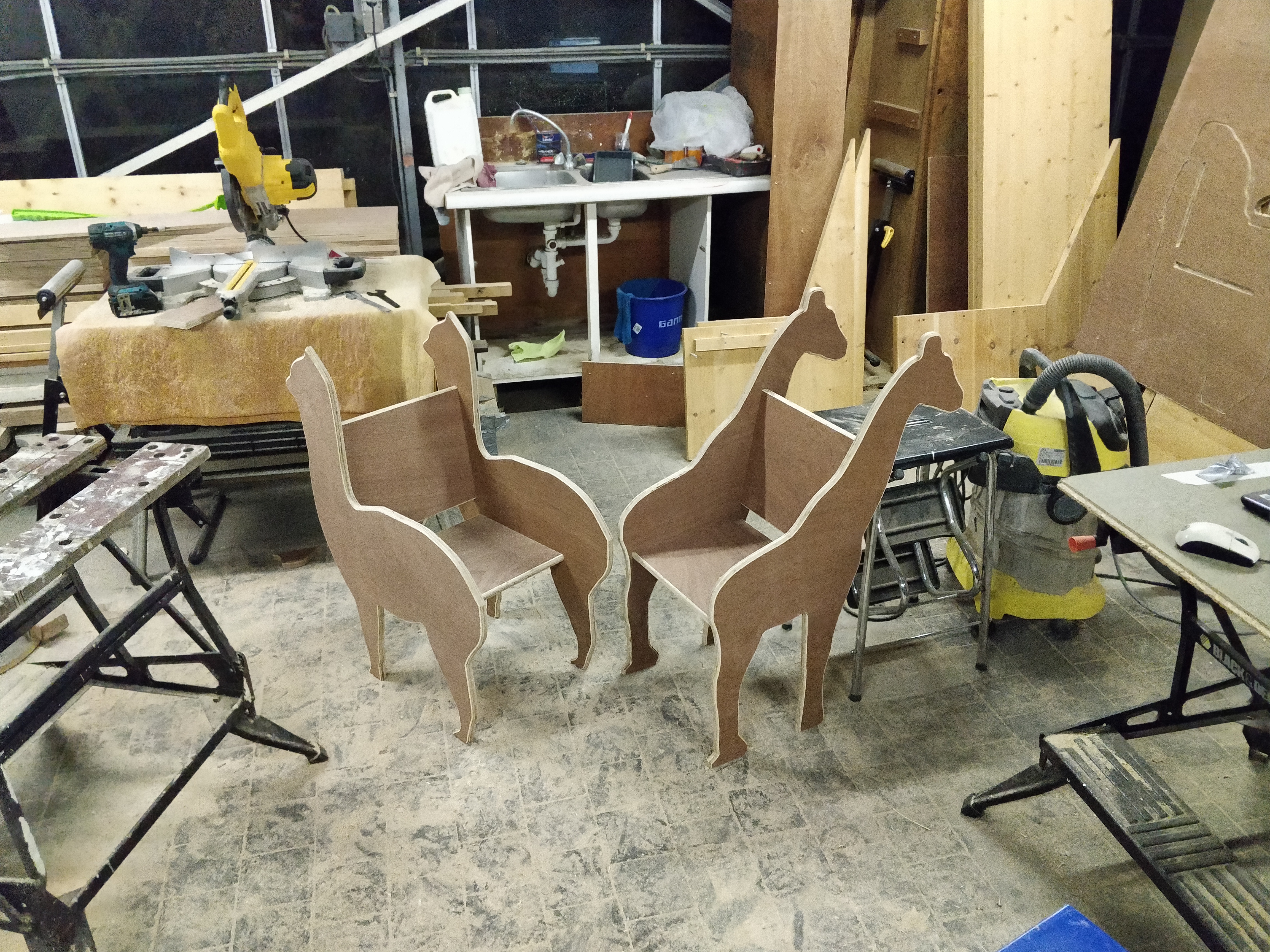

Finally got started on this, it’s gonna be the kid’s christmas present. My new years resolution is to make all presents myself this ( and next) year.
This is the first project i’m doing thas uses the entire sheet and so far it’s working out great, sure the slots are too small and the bottom left of the machine is crap, but that can all be remedied or worked around. But in the middle it is pretty much right on target.
The thing i’m not sure about, what should i do with the feet of the chairs, it’s quite cheap plywood on it’s edge, it is gonna tear out when the chair is moved around.
I was thinking some u profile that fits over the edge, but i can’t think of anything aestetically pleasing.
I’ll post pictures and fusion files of the rest of the build next year, right now i got presents to finish :slight_smile:

Wow!! Looking good! It’s great to see these becoming real :grinning:
