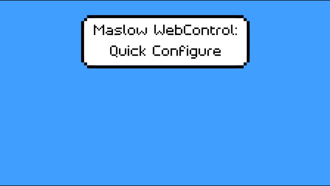

BASIC CALIBRATION TO GET STARTED:
(getting started / webcontrol calibration / beginner)
from menu above, select “Actions”
select Quick Configure and follow the prompts.
If that is confusing, please see video just below.
Calibration
  • how to make the quick configure measurements
  • how to extend chains / attach sled
  • how to [run triangular calibration
  • how to [upgrade and run holey calibration
